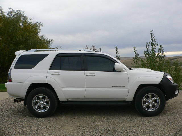

Hey - Anyone out there know anything about lifting or leveling an 05 sport edition? I just put bigger wheels & tires on my 4runner and the front end needs lifted so the tires won't rub the fender flares during turns.....The spring shop I went to said it can't be done because of the pneumatic leveling system.....There HAS to be a way right??? Any ideas, comments, etc. appreciated. I am attaching a photo....Thanks :awais:
Spacer lifts. You can get one from Cornfed, Revtek, Daystar or Toytec, etc.
There isn't any pneumatic leveling in the 4Runner except for the Limited V8 which has rear air suspension. The shop is probably referring to the X-REAS system, which they're partially right. If you want to keep the X-REAS system, you'll be limited to spacer lifts only.
