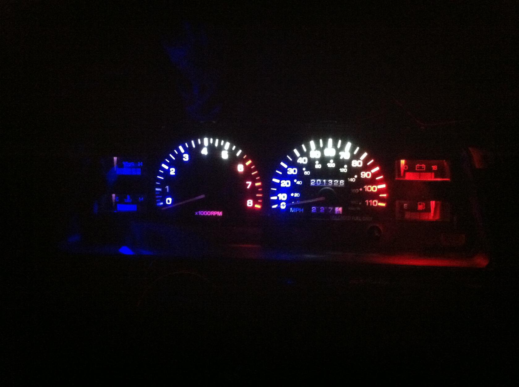

Automatic or standard? Any dash lights on, brake or O/D?
Auto, and no lights on the dash. Brake light has came on but replenishing the fluids has made it go away.
these are my only dash lights! :naughty:

Does it feel like it's shifting gears when you accelerate? Mine was kind of iffy when I drove it. Kinda like a go kart, mash the pedal and wait to get going fast. Like I was starting off in 3rd gear. Try manually shifting and see what happens. Mine turned out to be shift solenoids. Runs like a champ now...
