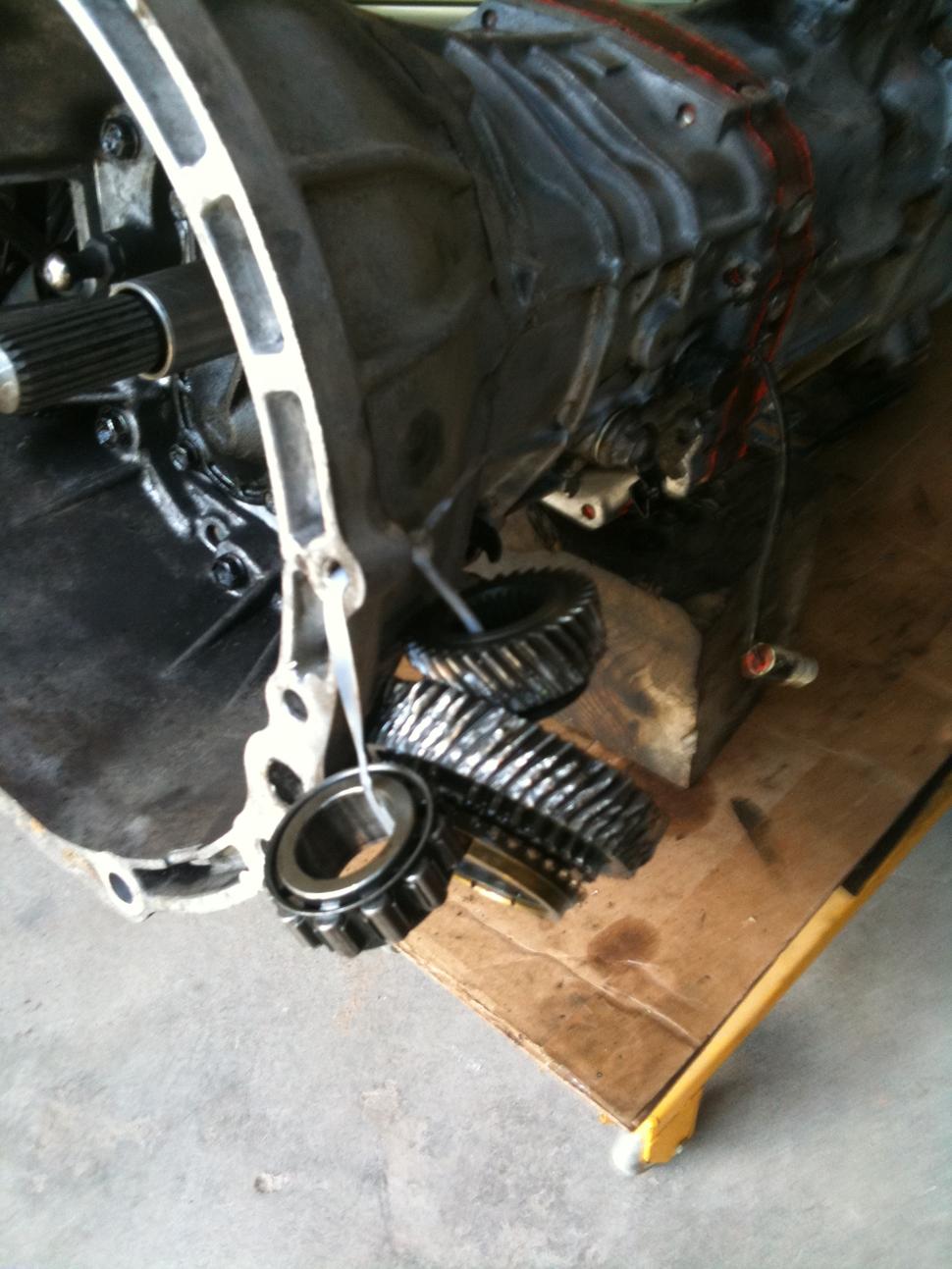

My 4th and 5th gear were torn to **** when I bought my 4runner and I pulled the transmission and had it rebuilt for $350 bucks
