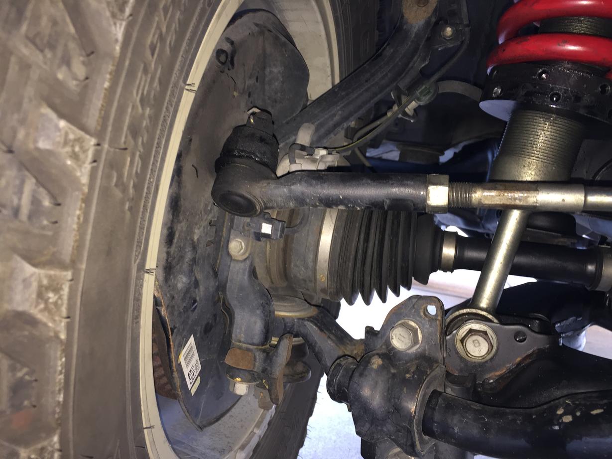

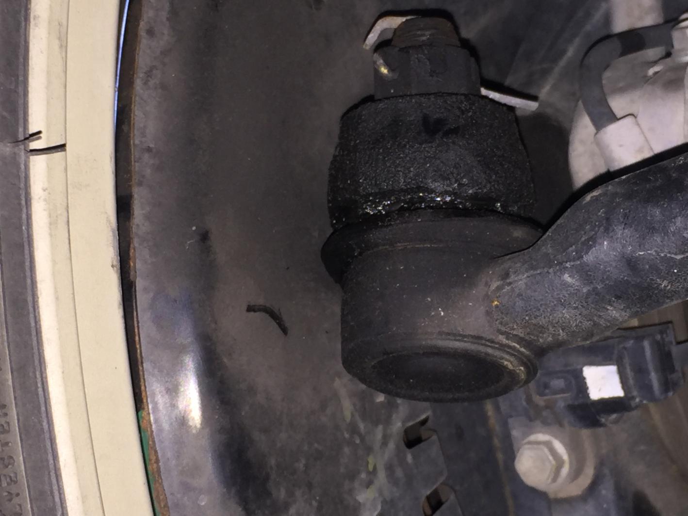

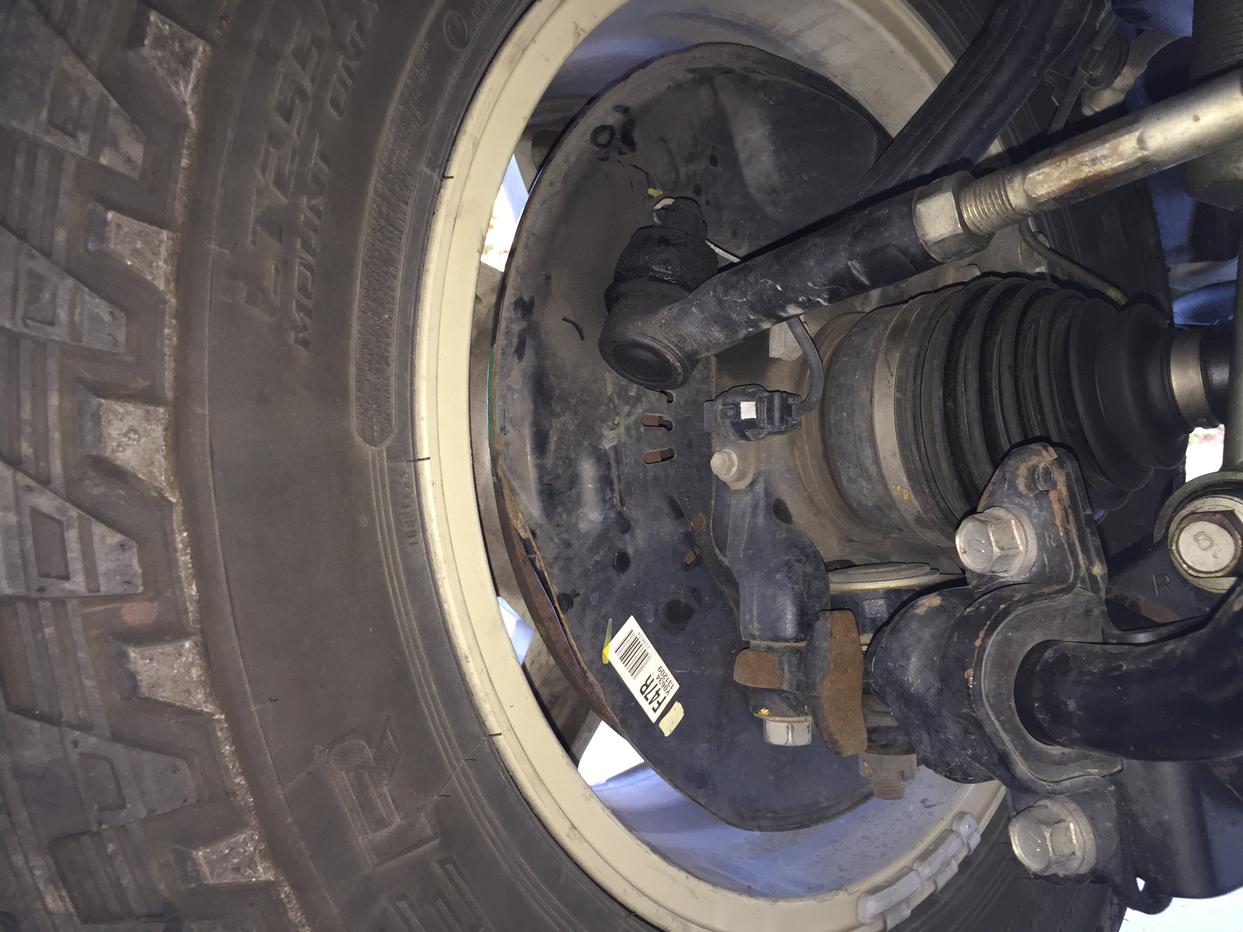

Had aligned today because of a pull to the right and asked them to check these. everything reported as ok and I confirmed. Still pulling right, still popping:wtf::wtf:
to top it off, i see this when I'm under there. Does this look cockeyed to ya'll?

Appears whoever installed your lift used a pickle fork TRE separator and destroyed your TRE boot. Time for a new one and another alignment.
In addition to your TRE needing a replacement, looks like your coilover might be leaking as well.
As much as i'd like to believe your alignment guy, i'd check the LCA bolt yourself. Make sure its tight, as there are a handful of us that have had the exact same popping noise. All connected to the LCA bolt.
Best of luck!
Best of luck!
Thats WD-40, I was adjusting my coilovers before my alignment
That popping is 100% the LCA bolts not being tight enough.
They need to be torqued down to around 130 lb ft. (Tight!!)
Every time they make that popping noise, they are changing the alignment spec too.
Go get it aligned (again) and have them tighten those LCA bolts to spec.
The LCA bolt is tightened and so far no more popping. Thanks all
