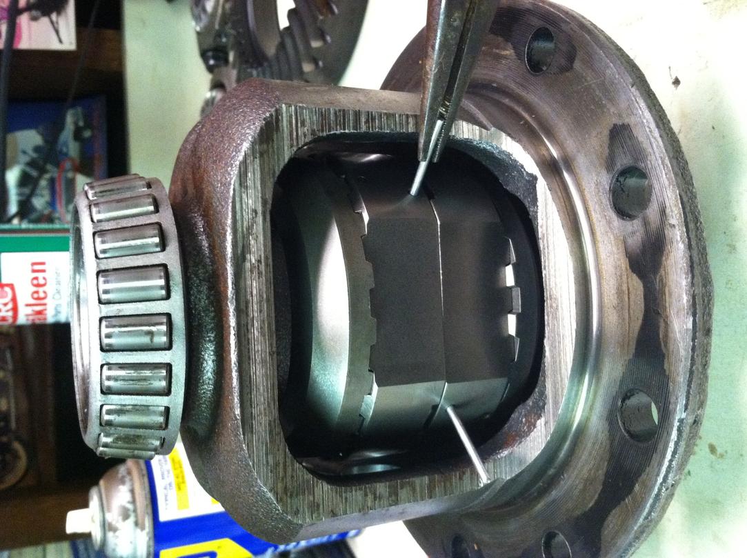

I went with a Spartan locker. $275 on Amazon w/ free shipping. Best upgrade I've made so far. It's made a huge difference.
