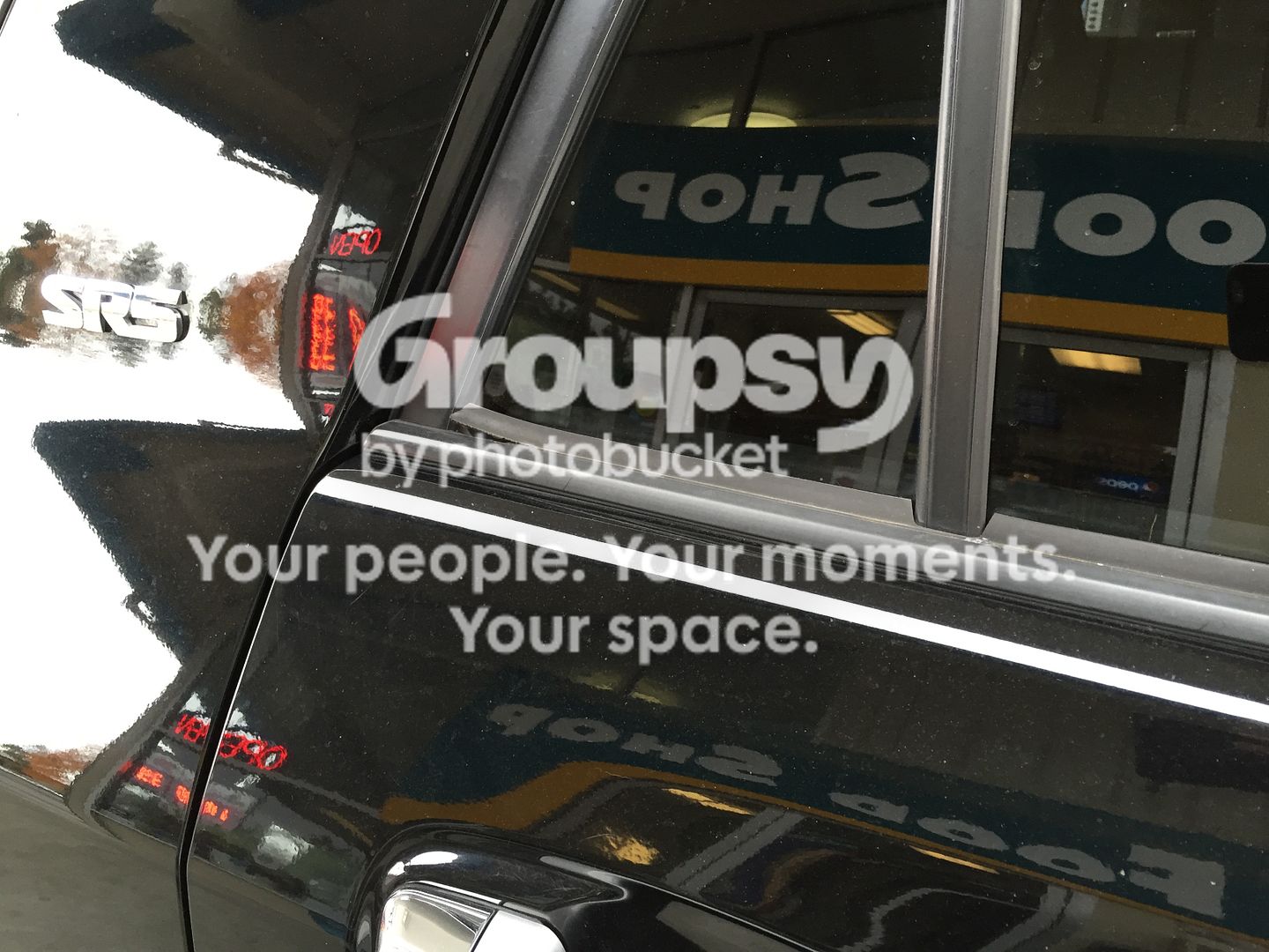

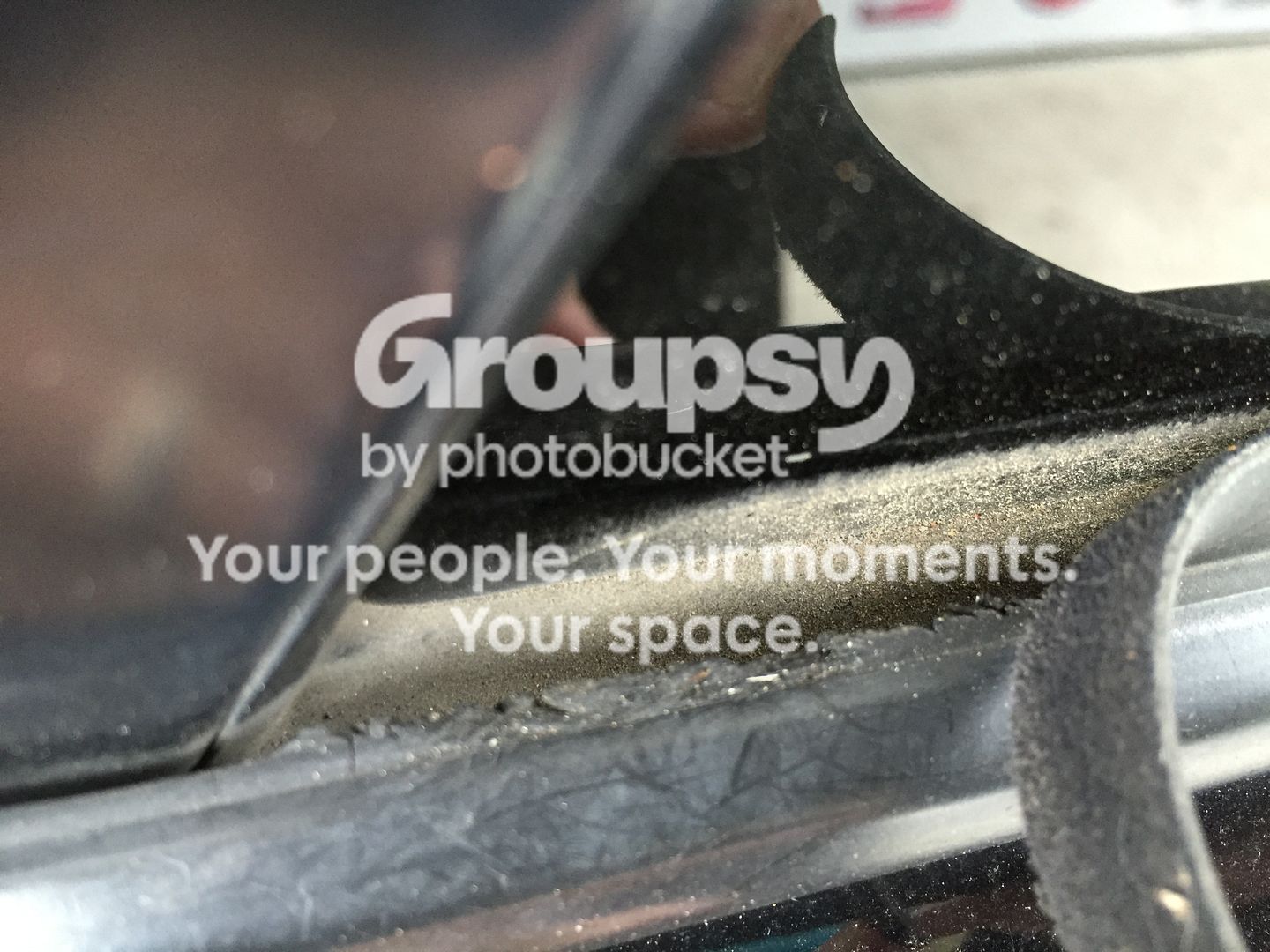

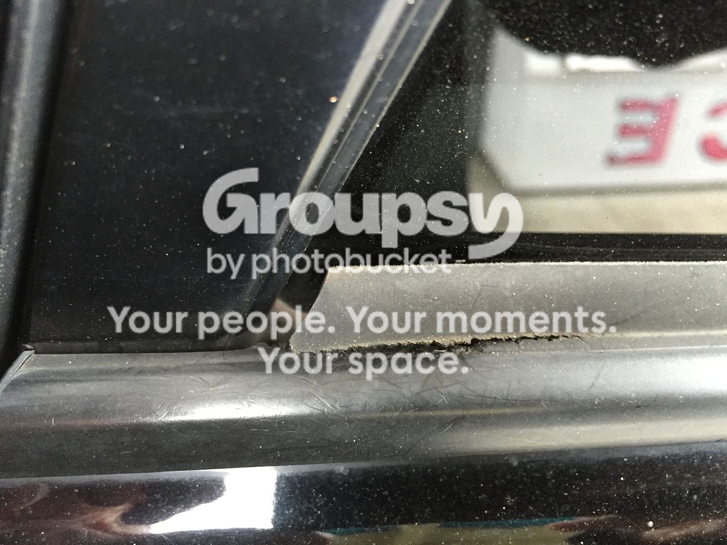

I was backing out this morning and saw a piece of weather stripping sticking up on the rear passenger door fixed window. Thought it was odd so I took a look when I got to work, it looks like the piece ripped up some how. Looking closer I see a bunch of scratch marks on the rubber where it tore. I looked at all the other windows on the car and the rubber in very good shape, no where near tearing. I pushed, pulled, and poked them, none of them seemed to be in a a state where they are deteriorating.
I'm wondering if someone thought they could tear this and get better access to "slim jim" the lock? I don't see how else this could have occurred. I think they saw that there wasn't any better access and left it or got scared off.
Another possibility is one of my kids 2, 4, and 6 years old could have some how got a finger in there and ripped it up. I think that is unlikely though.

I don't see any scratch marks inside:

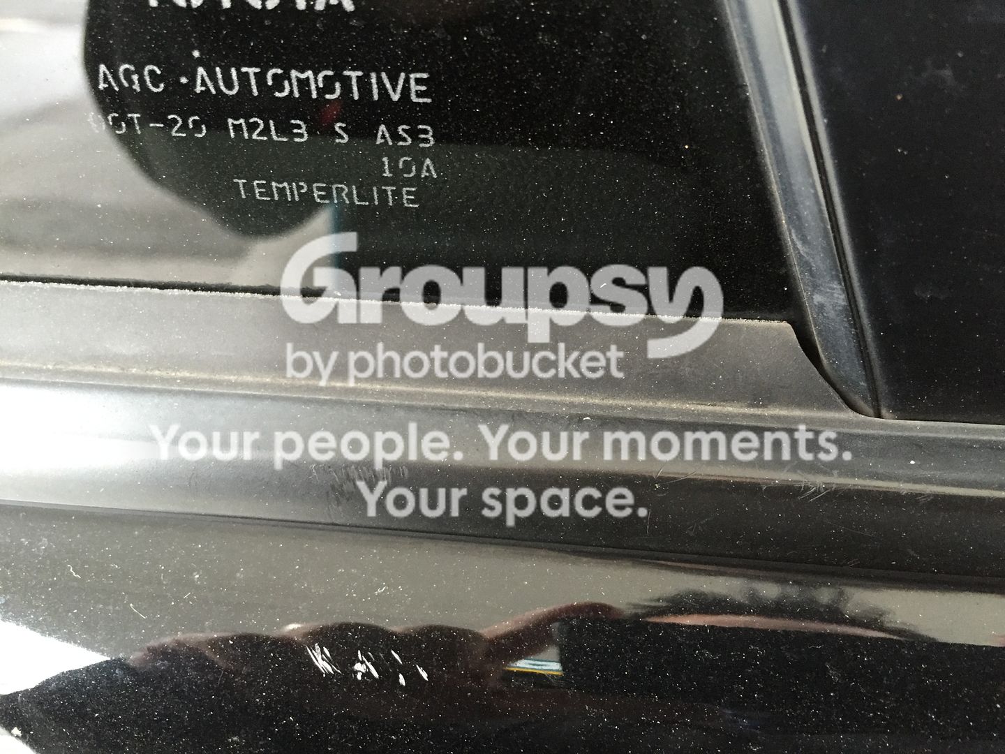

Other side for reference:
On my 03 4runner the molding started to dry rot like that and had to be replaced on some of the windows. Is it possible that the wind blowing the molding around caused the scratches?
I suppose its possible the wind could have caused the scratches. I really only drive to work and back on side streets under 40 mph though. Its a 2011 so its only 4 years old, you think the rubber would rot that soon?
I think someone tried to get a coat hanger in there to unlock the door. Thats just me though:thumb3:
Looks like vandalism to me. I had a 2004 SR5 from new to trade-in last year (10 years). None of my molding rotted or ripped like that. I live where they dump tons of salt at the slightest site of snow flakes and summers are humid hot.
Agreed! There is no way the force of wind from you driving was able to cause that. I'd keep any valuables out of sight for sometime.
I've replaced all four doors and the lift gate moldings on my '10. The sun really does decay them pretty fast.
They are called Belt Moldings. You can find a pictorial parts source here , But this source has the best shipping rates that I've found (you have to have the part number).
It's a two minute job to replace; pry under the old then just pull it out, the new one slips right in with a fist tap or two.
Someone intentionally did that. Most likely trying to break in buy jamming something down there towards the lock...
No way driving in the wind did that. C'mon haha.
Birds and squirrels do stuff like this all the time. It may not have a person.
