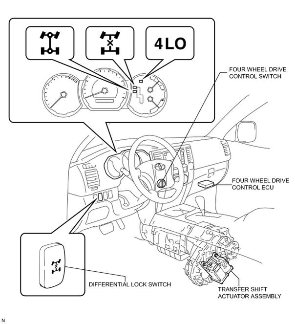

There is just one actuator assembly, but I am not positive what the inner workings are like though.
Just to update, The dealer said the 4wd computer wasn't putting out voltage to the actuator. They put a new ecm in and now there is voltage to the actuator but still no 4lo. They said the actuator is bad or something in the transfer case is jammed or broke. Good thing for a warranty!
