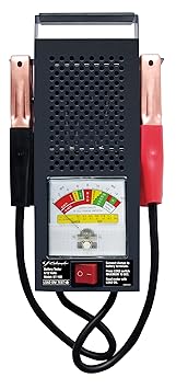

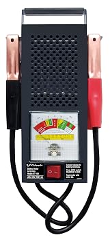

If you work on old stuff, DMM's (short of a Fluke or other high-end equivalent) are no good for diagnosing generator/regulator circuits. Too much noise so they freak out. I use the analog VM built into my battery load tester. Perfect scale 0-16 Volts. Something everybody should own. $22 on Amazon Prime.
I'd say half of all electrical problems end up being a craptastic battery or fubar'ed charging system. This thing checks both. Mine is older than many of the posters on here.
