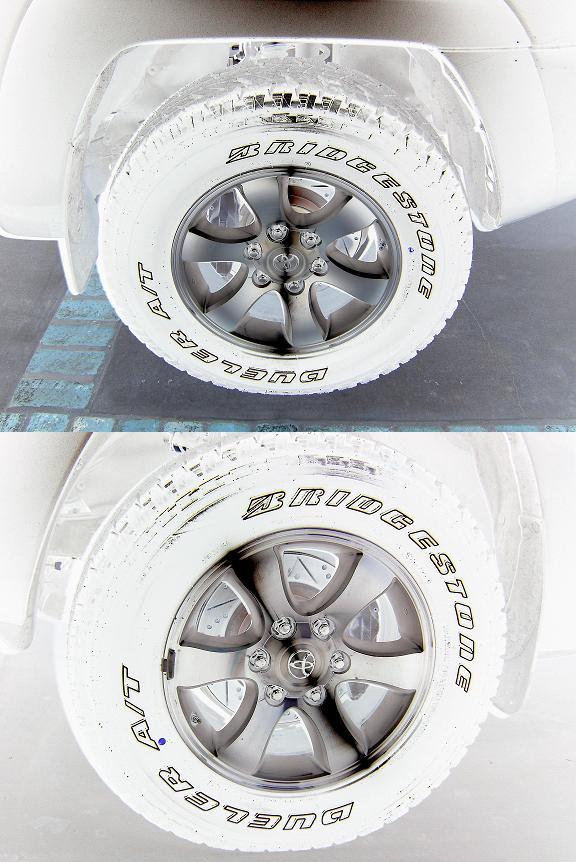

DanDLT, I'm trying to determine from your other pic thread if they installed a bigger tire for your driver/front. I know it sounds really crazy and please don't take any offense, but are you sure they installed a 265/65/R17 and not a 265/70/R17? Stock size should not rub. Tire shops do screw up from time to time. I'm just throwing it out there. I find it suspect that your original stock tire (I assume) didn't rub in the driver's front wheel well. I'm trying to see from your pics, but it's hard to read the side wall for any indication. I'm also looking at your side profile pic and comparing the driver's rear to the front. I may be going crazy but the front looks a bit bigger than the back. On the other hand, that may just be due to slight parallax as the shot may not be perfectly viewed perpendicularly.
Ok, so I took your photos and through my lame ass attempt to try and read the tires sizes I inverted the colors (like in astronomy - sometimes it's easier to spot a faint detail if the inverted image is scrutinized instead). I got nothing. However, I do see the slight difference (albeit different viewing angles) in the distance relative to the mud flaps. The right side is on top, driver's side on the bottom. That is certainly strange. Well so much for my Fisher Price scientific method.
Edit: I just re-read your post and didn't realize you had adapters on. Hmmm...
