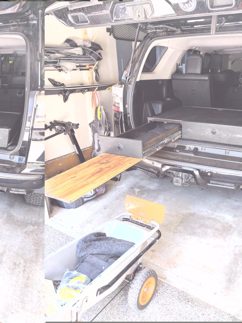

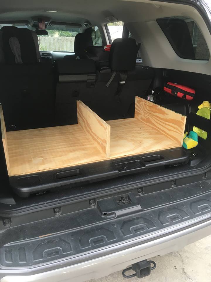

I needed something small that maximized space in the back for a bike. I also, wanted to be able to add a sleeping platform to the front. I mashed a bunch of other folks solutions. Thank you all for the good ideas.
How did you get the table to slide so far out? What track system is it?
I mounted to steel c bars to the bottom of the drawer. The table isn't actually on slides it just slides in and out of the steel bars. Friction hols it in place to keep it from moving so much.
I purchased my accuride 200 lb, 28" slides at cabinetmakerssupply.com .

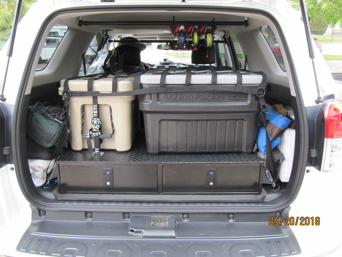

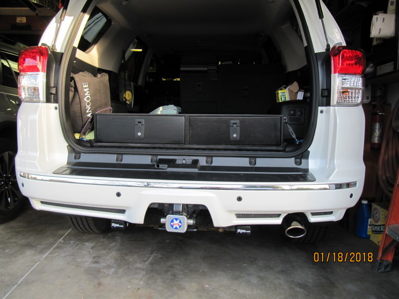

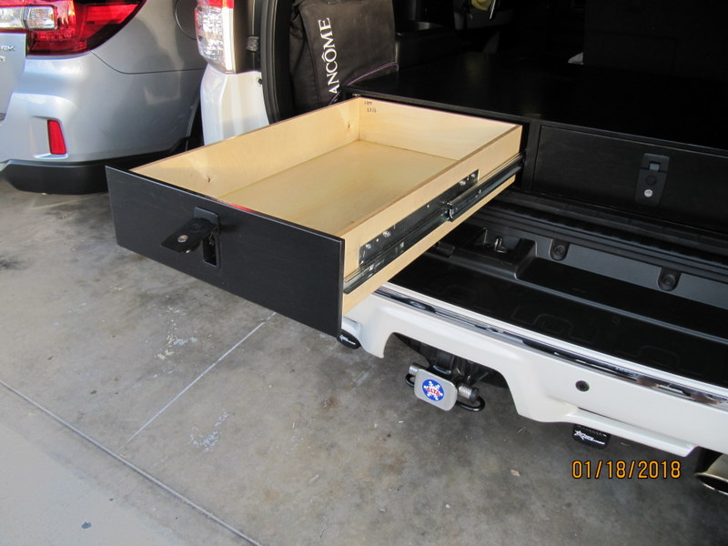

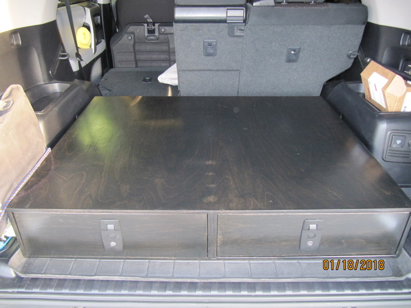

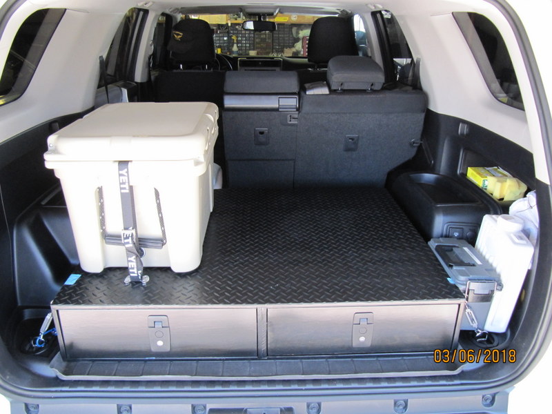

Just finished this Yesterday. looks like everybody else.
41 1/2" X 32" x 7" W x D x H
1/2" Baltic Birch, accuride 28"-200lb Glides. Goose Gear compression latches
Cabinet, Black stain 3 coats of poly. Drawers natural 3 coats poly.
Total weight 80 lb empty. I'll post more pics in my Album.

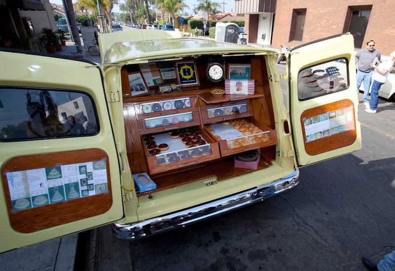

Here is the ultimate drawer system with survival food. LOL. Chevy panel truck operated by Helms Bakery Los Angeles Ca.

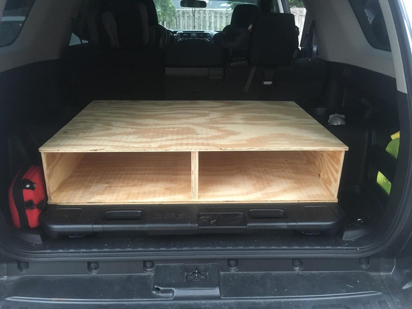

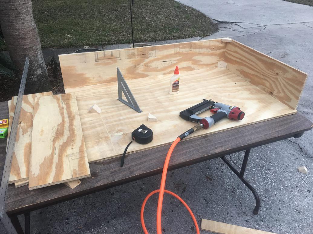

started on mine today. it will double as a sleeping platform as well.
My SR5 did not come with sliding tray or third row seats.
Looks GREAT!
