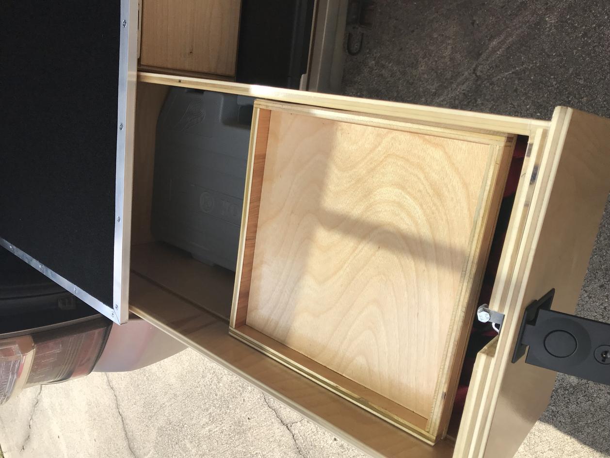

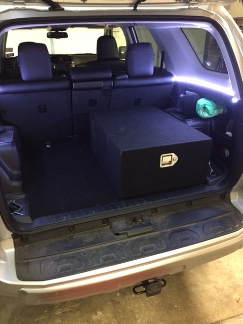

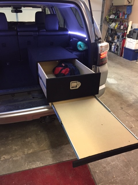

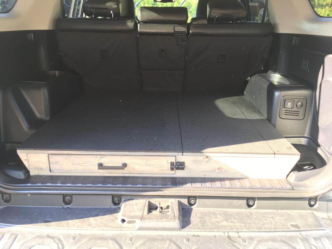

Finally got my drawer done and installed. I am definitely no carpenter so its not perfect, but it works and its good for me doing it myself! Thanks to everyone for posting up here with ideas, and to [MENTION=147480]aelarson[/MENTION] for answering my questions! I used amazon 28" slides, and picked up some black felt from a fabric shop for around $10 instead of ordering auto carpet.
Looks great! I am glad I was able to help out!

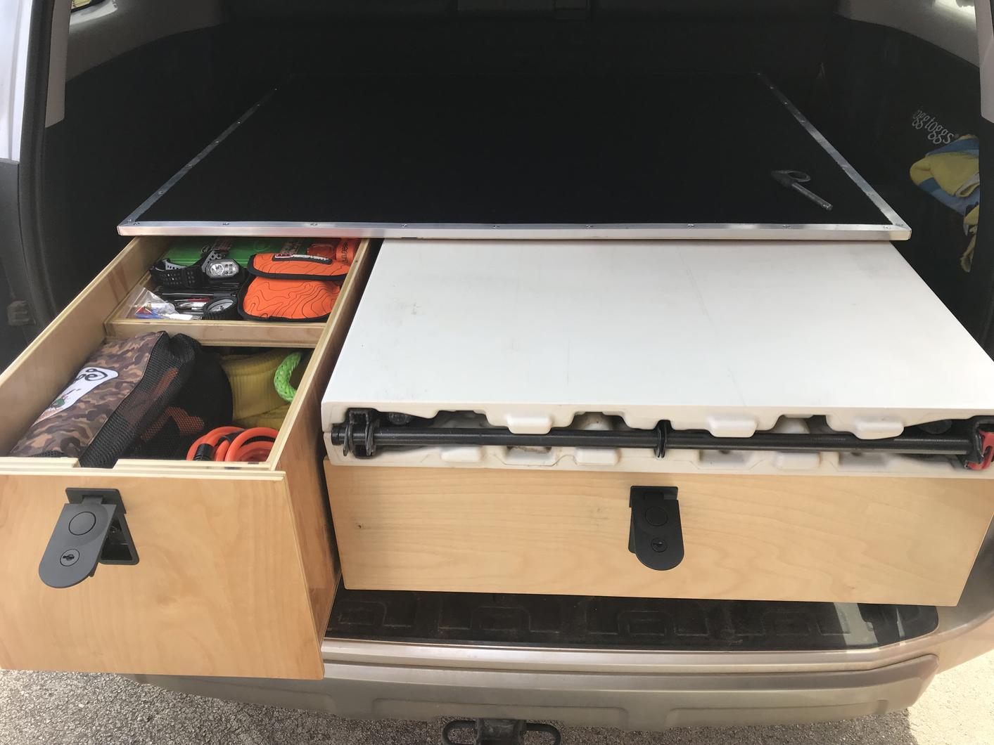

Okay, finally making some progress, albeit frustratingly slow when you are working 45 minutes at a time over lunch breaks at work.
The plan…
Two independent modules with two drawers each. This will allow one to be removed for use with a third row seat. Driver side will get a sliding cooler tray mounted atop.
Construction is all 1/8” aluminum…
My original plan was to design both of the top drawers in the fashion below, with the drawer base having tabs that penetrate the vertical sidewalls for strength, and the vertical sidewalls mounting the drawer below, allowing it to be extended with the top drawer fully extended, but I switched gears and am just incorporating this design on one side now. This is the driver side module.
For the passenger side module, I somehow stumbled on a YouTube video of the set-up available from JeepKitchen.com (appears to now be OverlandKitchen.com) and loved the lower drawer “cover” that doubles as a prep/work surface. This work surface extends first, then the lower drawer housing the stove or whatever is mounted below that and can be extended out beyond there. Seems like an ideal use of space!
Mounts are 1/8” thick steel which will be bolted to the factory tie-down points on the outsides. I am using carriage bolts in the slots to allow for one-side-only fastener tightening and of course, tolerance. Despite the photo/test fit, looks like I will have to nix the tie-downs as they sit just a bit too high with the steel brackets below and are going to interfere with the cabinet base. The plan for the center mount is an extended length version that will hopefully share some mounting space with floor bolts for the third row seats. Hoping to have some time to check out that potential this weekend.
That’s it for now. I am just starting on the “cabinet” portion of the project. Might seem a little backwards or atypical, but I wanted to work from the inside >>> out in case my drawers were a little out of spec, it’d be easier to make adjustments to the cabinet frame size rather than trying to cut the drawers down. Would hope to complete the driver side module in another week or two, then I can roll into the passenger side unit. More to come…
Rear center mount done. Probably will not worry about an additional center mount near the hatch; I think two mounting points front & rear on the outside, and two points on the rear half on the inside for each module will be sufficient, but we’ll see when I get the drawers completed. When both drawer modules are installed together (most of the time) they’ll be bolted together anyway.
I had not originally planned on pulling out the whole unitized third row seat, but it quickly proved necessary, came out with only 4 bolts, and turned out to make working in there much simpler anyway.
Floor plate, mounting location.
Mocking things up. Added some weight to flex the third row seat down some to simulate the installed drawer module.
Completed bracket.
Installed.
Getting closer! Still a long way from being done, but pretty exciting to see 6 mos of design work and slow building finally starting to turn into something. The extension on these 28" slides seems huge, can't imagine some of the bigger slides some folks are using!

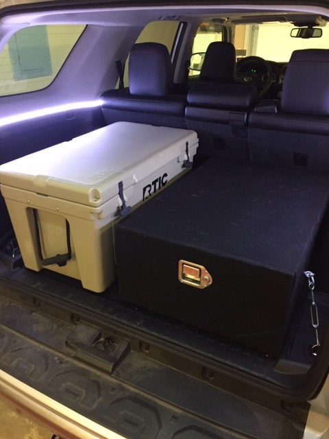

Lifted ARBs
Two ARB drawers, lifted so a 35" square folding table slides underneath. It can be used for camp life, ro for "parking" the drawers in the garage when I want the full cargo area available. Drawers are turnbuckled to the load D rings.

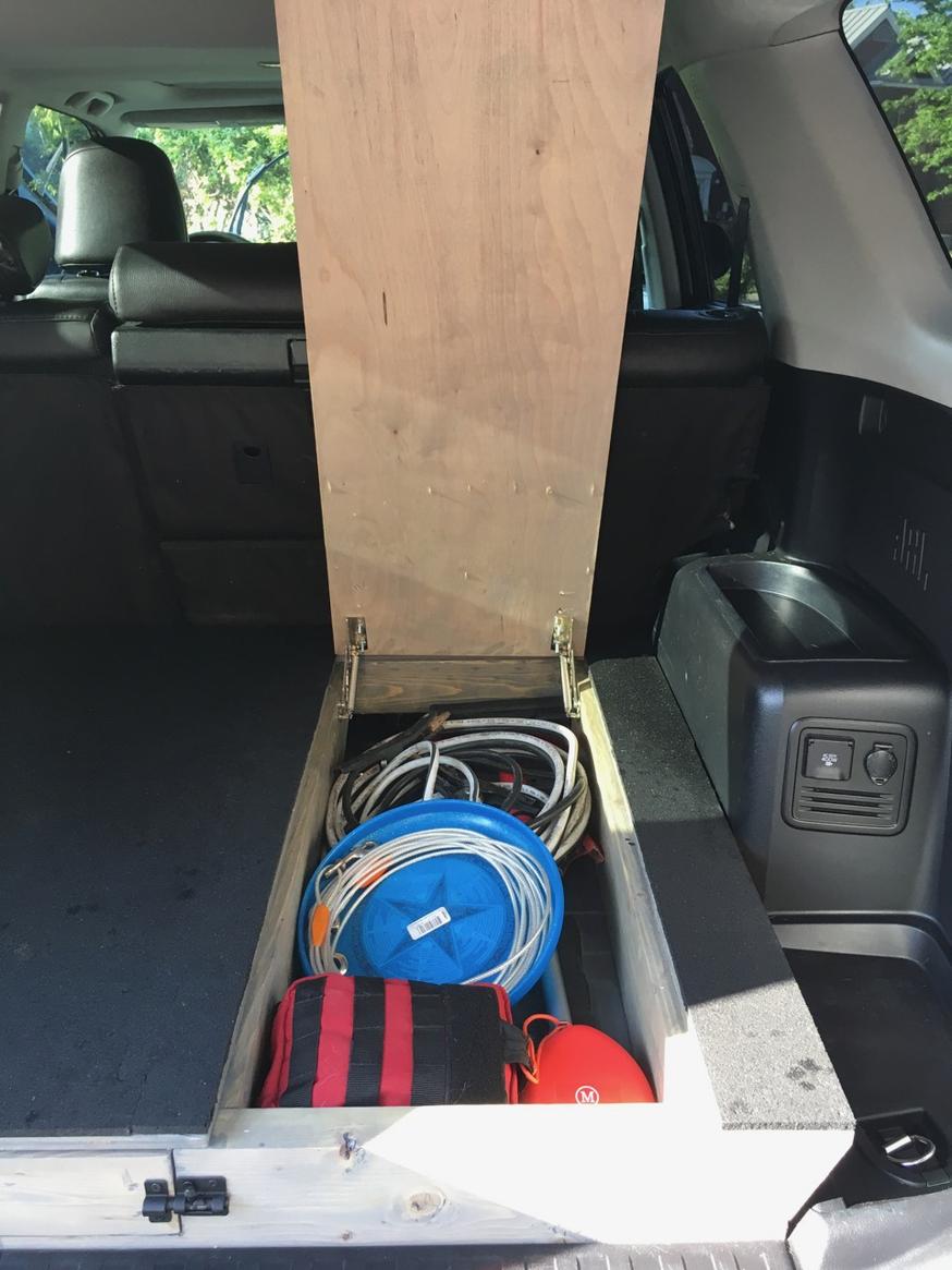

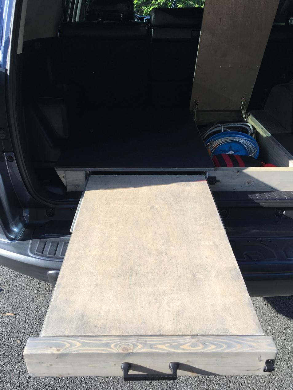

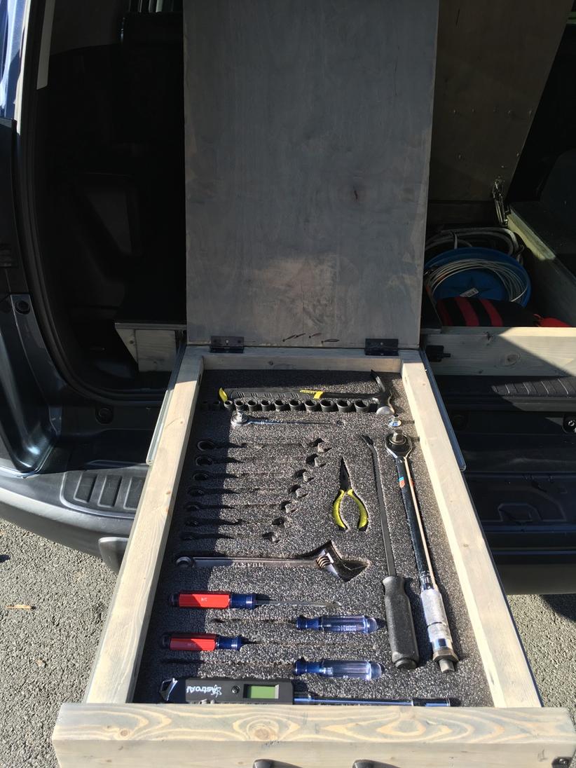

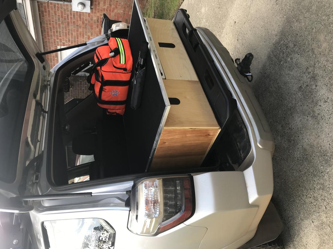

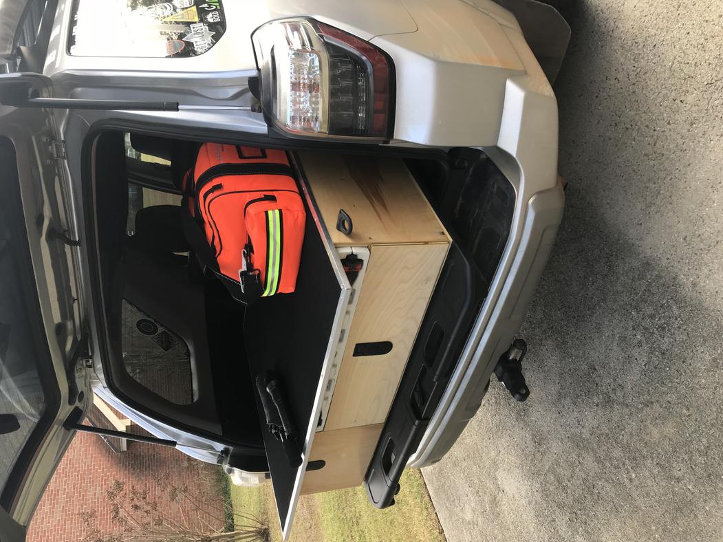

Drawers version 2 on sliding cargo deck!
Finished these up recently and continually tweaking but am now confident these are in for the long haul. Sorry about rotation of pics, I'm lost!

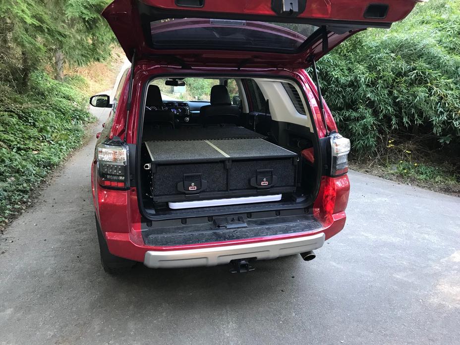

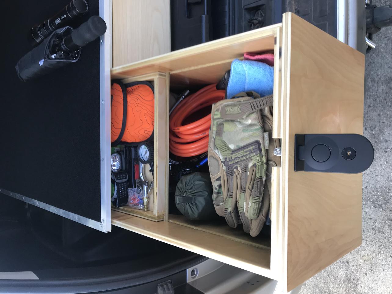

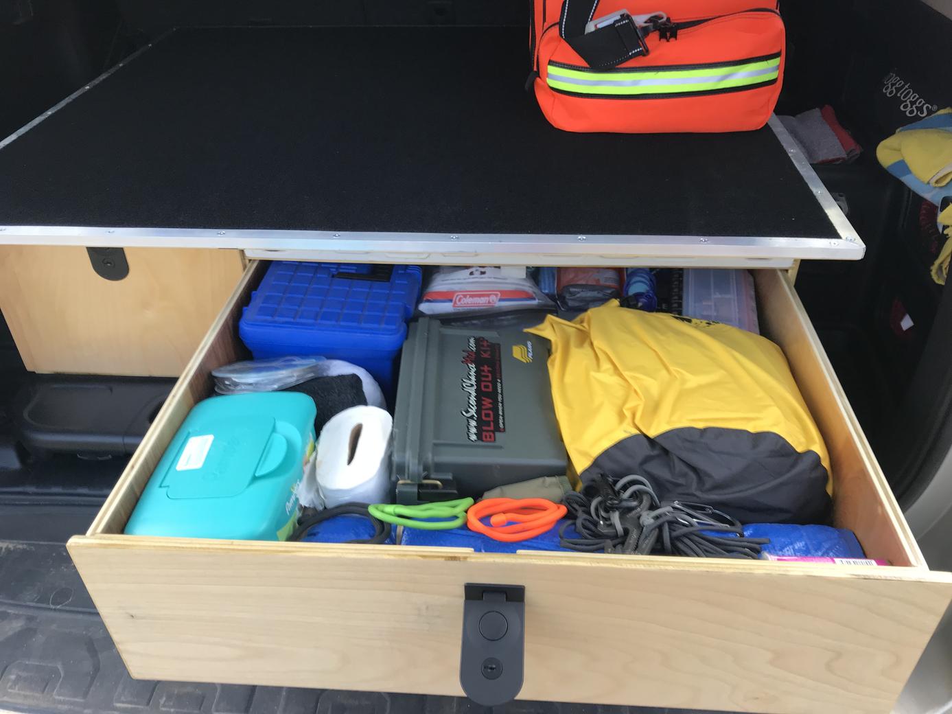

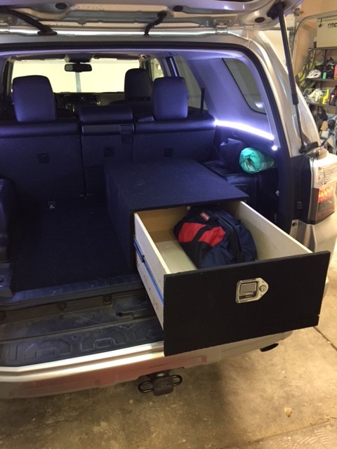

Finished this today. Pretty happy with how it turned out. Rubber gym flooring on top so the dog doesn't fly around the car. Drawer can support up to 500lbs; plan on using it as work station while camping or seat when needed.
Pops,
Does this sit flush with the rear seats when they are down? I've been looking at making a platform to sit flush so I can sleep in the back, but that pull out tool storage is perfect. What kind of rails did you use on the drawer?
