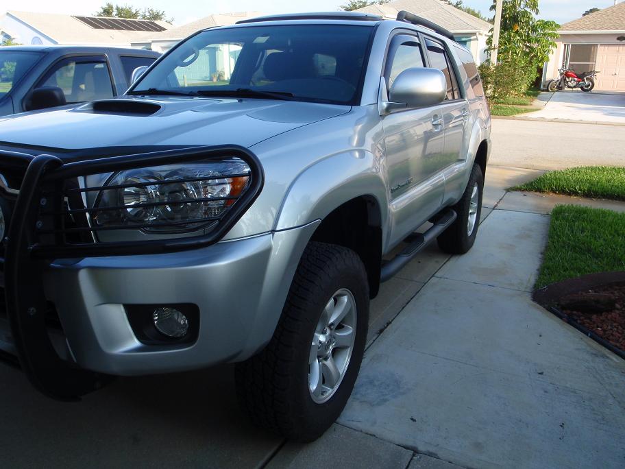

You all know I put my lift in last month and I am looking for others that have installed this lift to compare before and after lift numbers from ground to bottom of fender opening. Here are my numbers.
Front Before 34"
Front After 38 1/2"
Rear Before 36"
Rear After 39"
As you can see I netted 4 1/2" of lift in the front and 3" in the rear. Just want to know if every one else netted the same results with the Toytec 3" ultimate lift. I called toytec and they said my numbers are right and my front must have been really sagging.

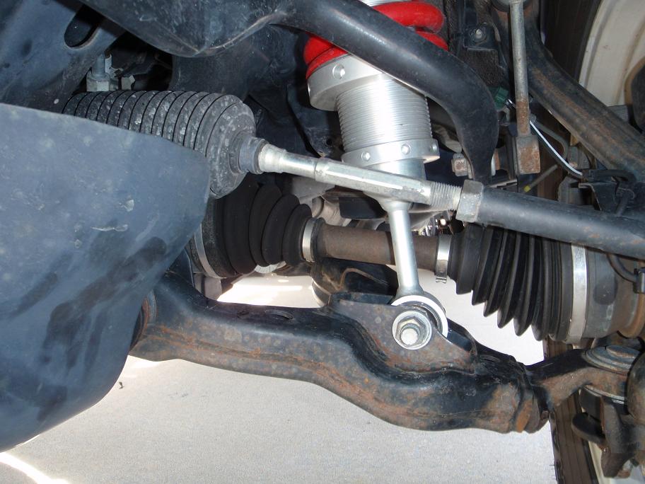

I am keeping an eye on the cv boots. the front coil overs from Toytec was set at the factory and was to be only net a 2 1/2 to 3" of lift. I didn't change anything just put them in. So I am not sure why I ended up with 4 1/2" of lift unless my front end was really sagging around and 1 1/2" due to the grill guard I had installed but I didn't think it weighted that much. Does anyone have the same lift and have before and after numbers? I will be adjusting the lift down if it doesn't settle down an 1/2 to 1" over the next few months. I might get my shrockworks bumper and that might help weight the front down some.

I think your before numbers not only show no sag at all but are above average by 1/2 to 1" unless your before is with the larger tires then you are still avg and no sag.
My before numbers are after I up sized my tires to 265/70R17. I will take a picture of the cv boots when I get home from work. I am just wondering why I ended up with about a 1" more lift all the way around. Will it settle that much or am I going to get a little more or less sag as the new suspension breaks in?

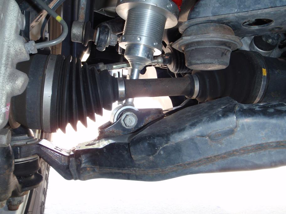

Here is a picture of the from the front looking back at the driver side. I did install the 1" diff drop.

And here is one from the back on the driver side. also on a side note the coil overs are still at the setting they arrived at which is 1 3/4" of treads showing.

Within just a couple of weeks, you should see some mild settling on all the springs.
We have found with the 4th gen 4Runners, that Toyota has these vehicles coming from the factor lower than before, creating some higher numbers on our leveling kits.
Your CV angles look pretty normal for a lifted vehicle.
If you do want some more down travel, especially when you go off road, the UCA's are a great addition!!
And then sort of the same thing with the brake lines, if you don't plan on 4 wheeling the rig, your brake lines are fine, but if you want to have some fun on some rocks, I would recommend longer brake lines.
Hope that helps,
