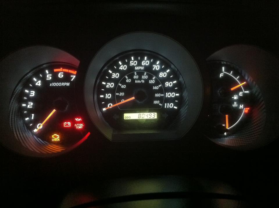

Finished my LED light change last night...Also, added some carbon fiber vinyl also..
^^^ diggin the carbon, its pretty sweeeet.
