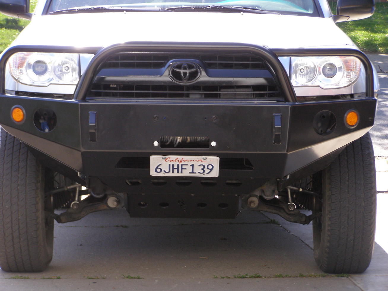

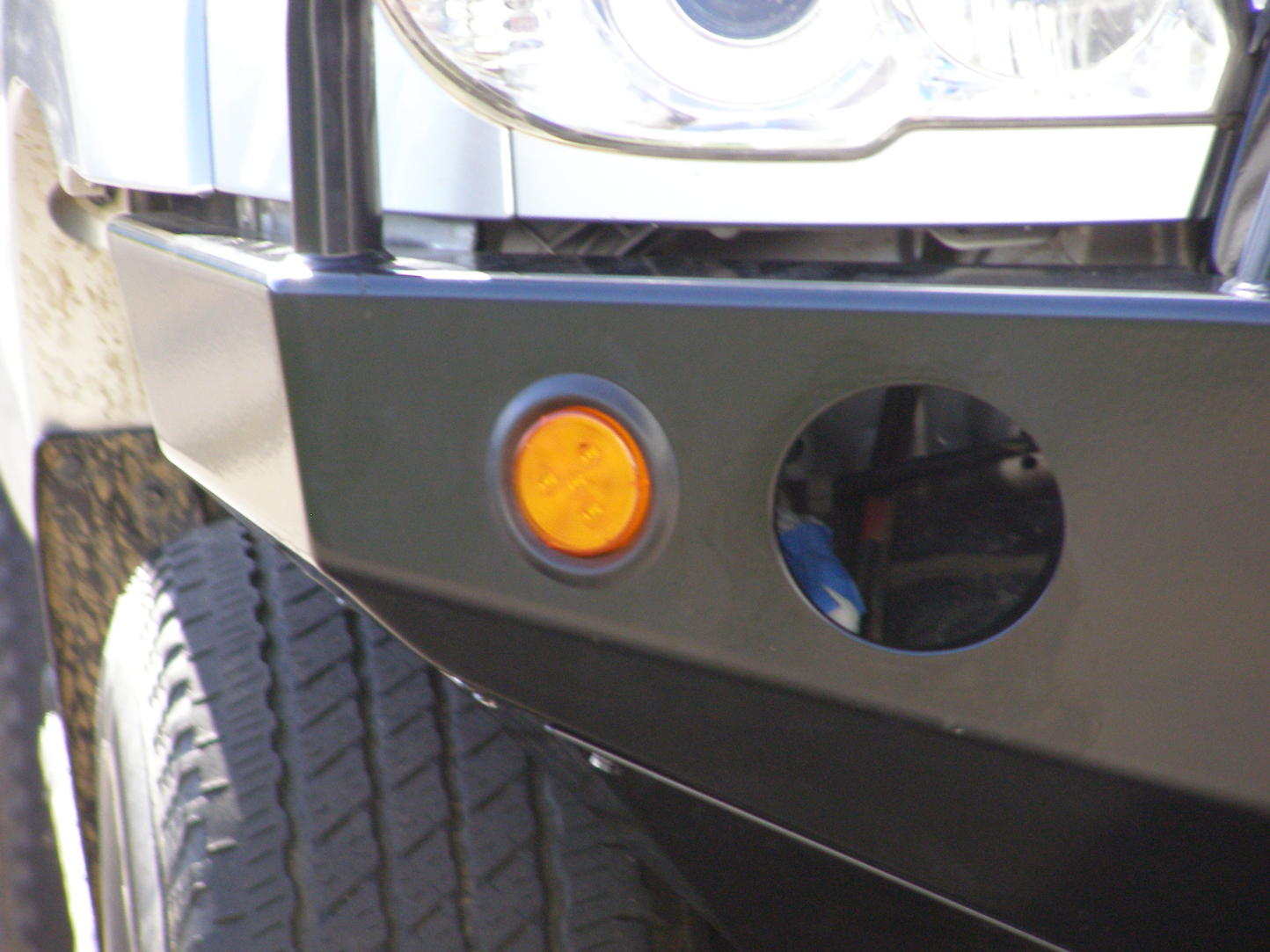

If you go off roadding, or should say, going into places that you will be doing some serious flexing angles. You will WANT that gap, unless you plan on replacing, and re bending mounting areas of them parts area.
I have a 3/4 " gap. And comes close on touching at times.

[MENTION=88231]having fun[/MENTION] where ya been? You need some UCA's, I spy a maxed alignment cam under there. This makes me want my SW here even more. Looks great. I'm going to leave gaps like that and put some weather striping there to help cover it.
Thank for caring Zak. Works been real slim the last year, got to far behind. I was forced to start line driving again/ OTR. Central valley to Los Angeles/ San Diego and back. Home for the weekends only.
That photo was when I first put on the bumper and the guys at Big-O pulled the alignment in from one side only.:bash:
I have the LR UCAS shortly afterwards and have my normal shop re alien. Not maxed anymore.
The brackets on the SW made it easy to up and down/ and tilt. Drill a third hole to keep keep in place.

Some day I plan to pull it off and paint the gap area inside black to hide the appearance of it.

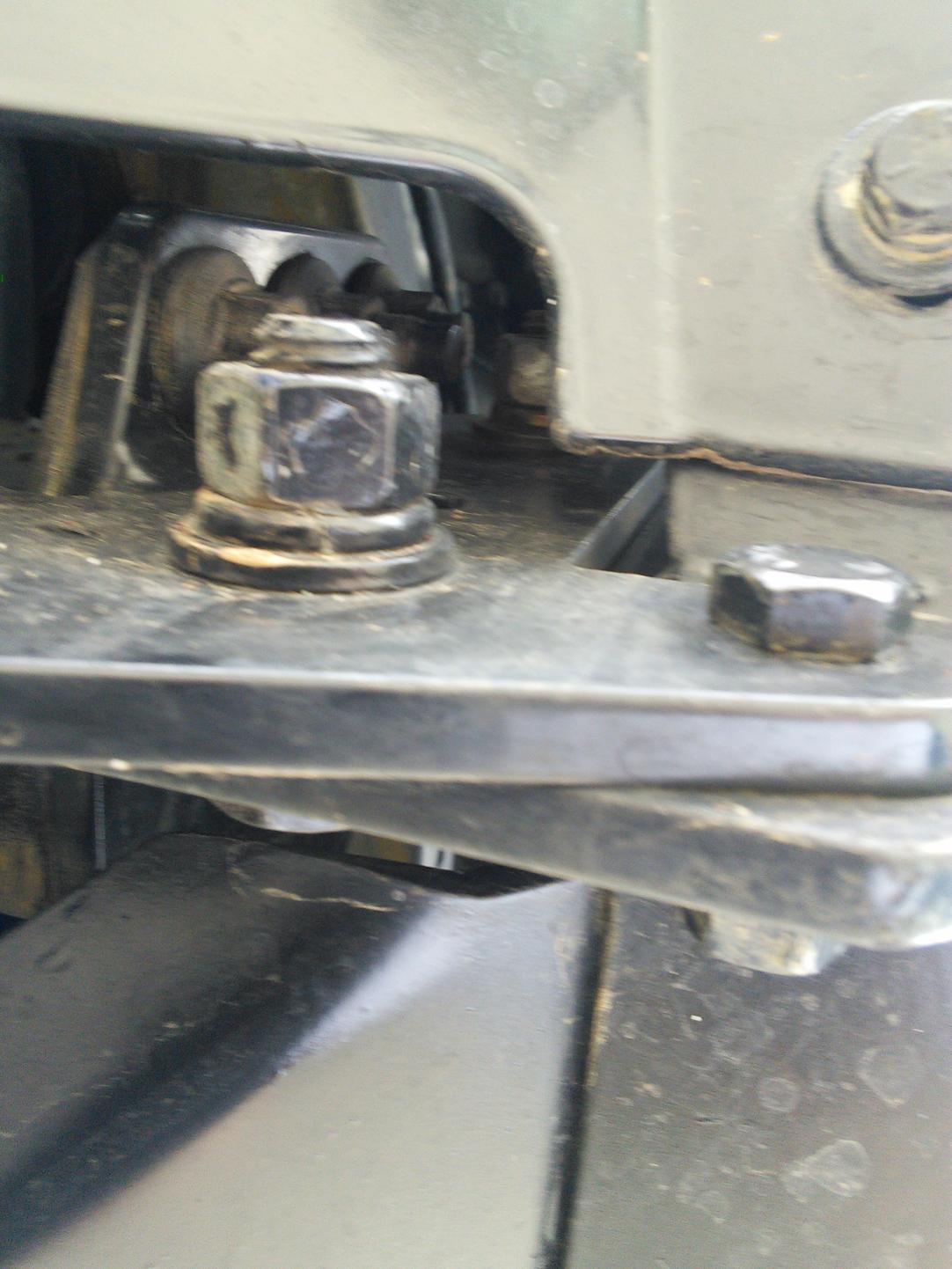

Just busting your balls, glad to see you back around. What do you mean by drill the 3rd hole? have a pic of the mounts?
Sorry, deleted the prior post, was still typing and the computer glitched.
You can mod it as you please.
I'll take a picture in the morning for you, the mount has the one hole already and you just finish the follow through hole for the bolt for keeping it in place.
[MENTION=55855]zopperman[/MENTION] The small bolt on the right has a hole on the mounting bracket already. When you have the bumper in place where you want, just drill through the bumper to put the bolt in to keep in place.

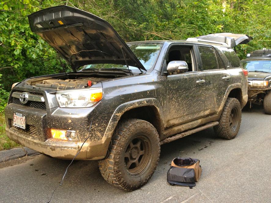

Here's my offroading front bumper pic that offers so much protection. Oh…it's supposed to be aftermarket?

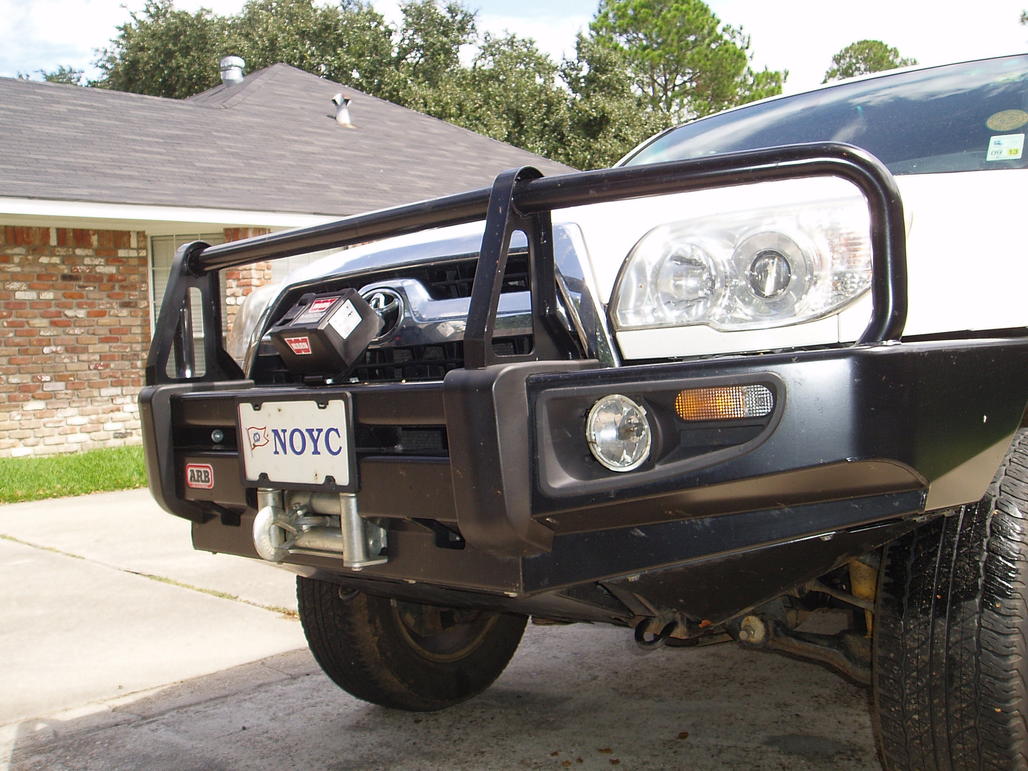

How about a TWOFER?????
3rd Gen: Addicted Off Road Tube bumper on my '99:
2012_0419_090200AA.jpg~original

^That mud is certainly aftermarket :)

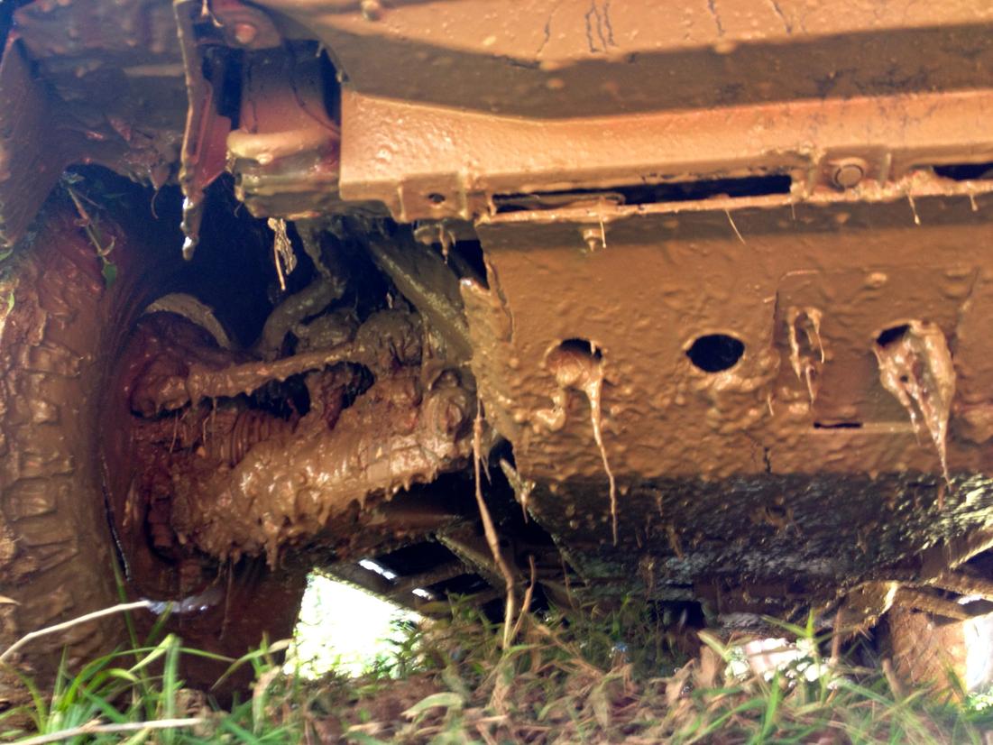

I don't want to get too far off topic on this thread but here's another from that day. I think I'm still cleaning out the dirt from that day.
