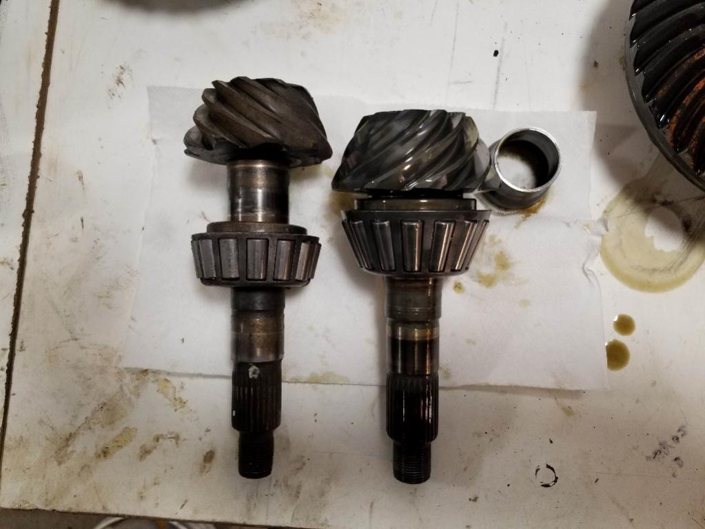

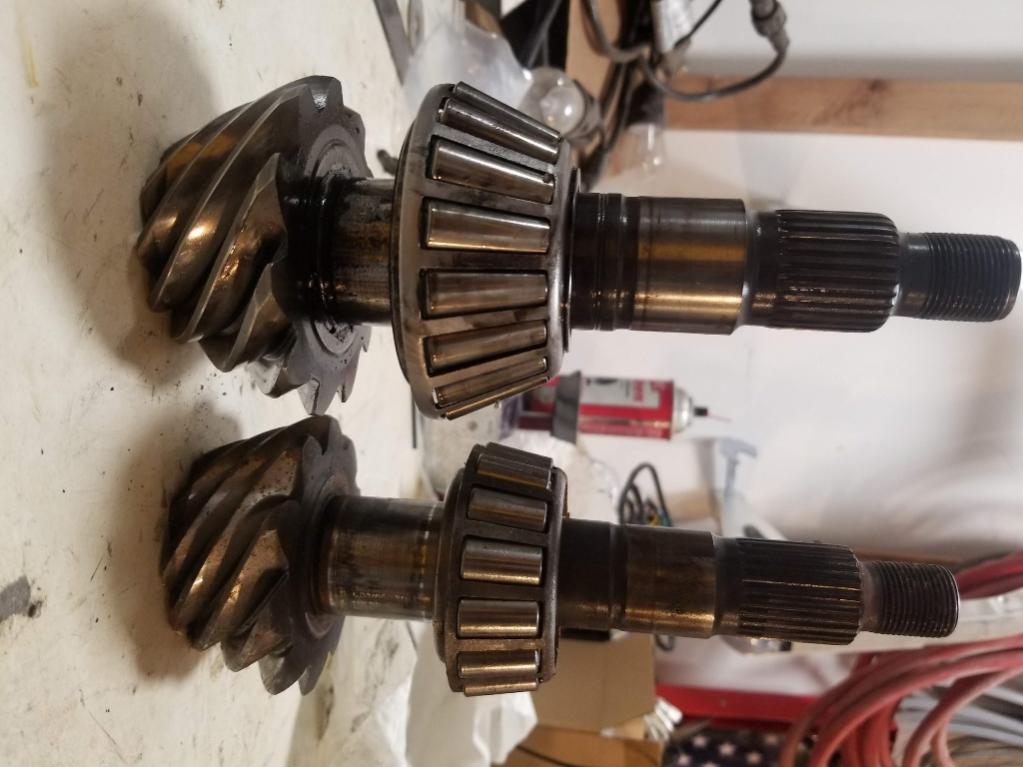

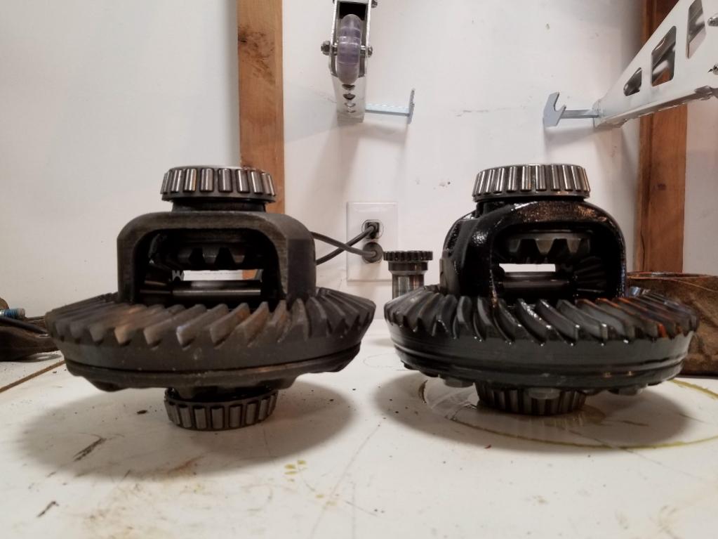

I've been trying to get smarter on gearing, but I'm not sure I can see the value in 4.10.

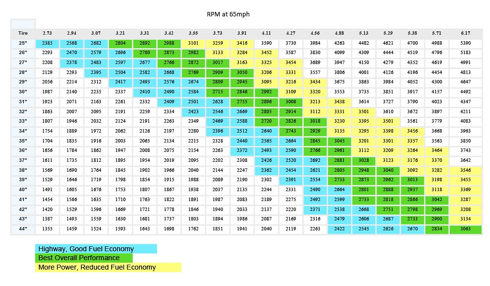

I'm almost with you - here is simple chart that sums up what is holding me up.
Maybe this oversimplifies it or maybe you don't even agree with the chart (stolen from tiresize.com/gear-ratio-calculator/).
But this amongst other things is what convinced me we should have been around 4.11 stock.
And re-gearing towards power/performance or increased tire size you'd walk up to 4.27 or maybe 4.56.
I think I'd want to keep it under 3000 RPM at 65, so I'm hesitant to embrace 4.56.

FWIW - that gear ratio chart doesn't really have much application in modern vehicles. It's based on a 1:1 drive ratio - I don't think any current vehicles from any manufacturer still have a 1:1 ratio top gear. But it is valuable in the sense that it shows relative changes in tire and gearing and how they compare. I just wouldn't put much or any value on the colors or the representation of how they translate to performance. Other than transmissions, it also doesn't necessarily match our engine's attributes. I have no idea what engine they were using, but I'd guess an older small block chevy.

I was tracking that most sites/charts were using 1:1 as their baseline.
I wasn't sure why other than easy math-comparison.
