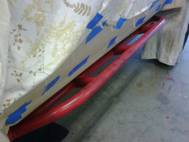

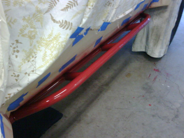

As to cost...I used cheapo Ace Hardware on the sliders when I first installed them....because that is what I had in the garage at the time.
For the repaint, I used Rustolium and it came out great!

it does look great for a spray paint job i must say, and no I haven't sanded anything, that maybe the problem i guess.....
