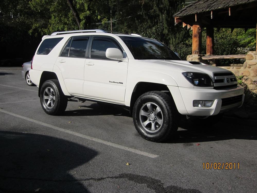

Not much has changed from above pic, added 2008 Sport tube steps. Guy i bought the steps from wants to trade my roof rack for his tube roof rack. I think that is a no-brainer. The wife and kid like mine better, but what do they know. I am supposedly picking up some limited 18's friday if work permits.
