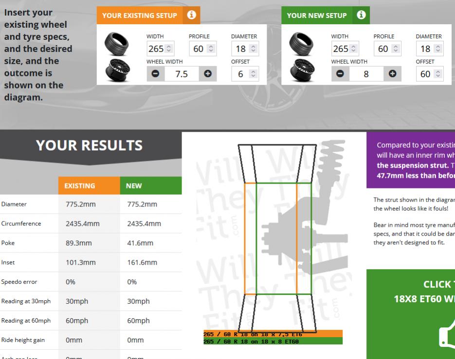

Looking here they appear to have a positive offset of 6mm is that correct? and a width of 7.5
I am currently running 265 60r18 Toyo open country AtIII tires
I would like to purchase a set of "2022 18" Toyota Tundra SR5 OEM Factory stock wheels" per the listing
But according to this website
Toyota Tundra 2022 - Wheel & Tire Sizes, PCD, Offset and Rims specs - Wheel-Size.com
The positive offset is 60mm.
Which means the wheels will be a helluva lot closer inside and likely to rub.
Want a second opinion before I f*ck and purchase these. Would I need some spacers to make these work?
Also, looks like I would need to increase the bore size.

60mm offset seems like a big change pushing inwards.

All the 2022 Tundra wheels are 6 lug. I have a pair of 2022 wheels I was going to try and run on my 2005 Tundra which has the same bolt pattern as our 4Runners.
The problem is the offset, you will need wheel spacers to clear the spindle.
You will also need wheel spacers that adapt from m12 to m14 threads as the 4runner conical lug nuts wallow around in the bore. Newer Tundra's must use m14 studs.
You will also need wheel spacers that adapt from m12 to m14 threads as the 4runner conical lug nuts wallow around in the bore. Tundra's must use m14 studs.
Got it. Thanks for the info. Didn’t realize the difference in the stud size. I figured bore difference would be easy to change, but alternate studs would be a pain
