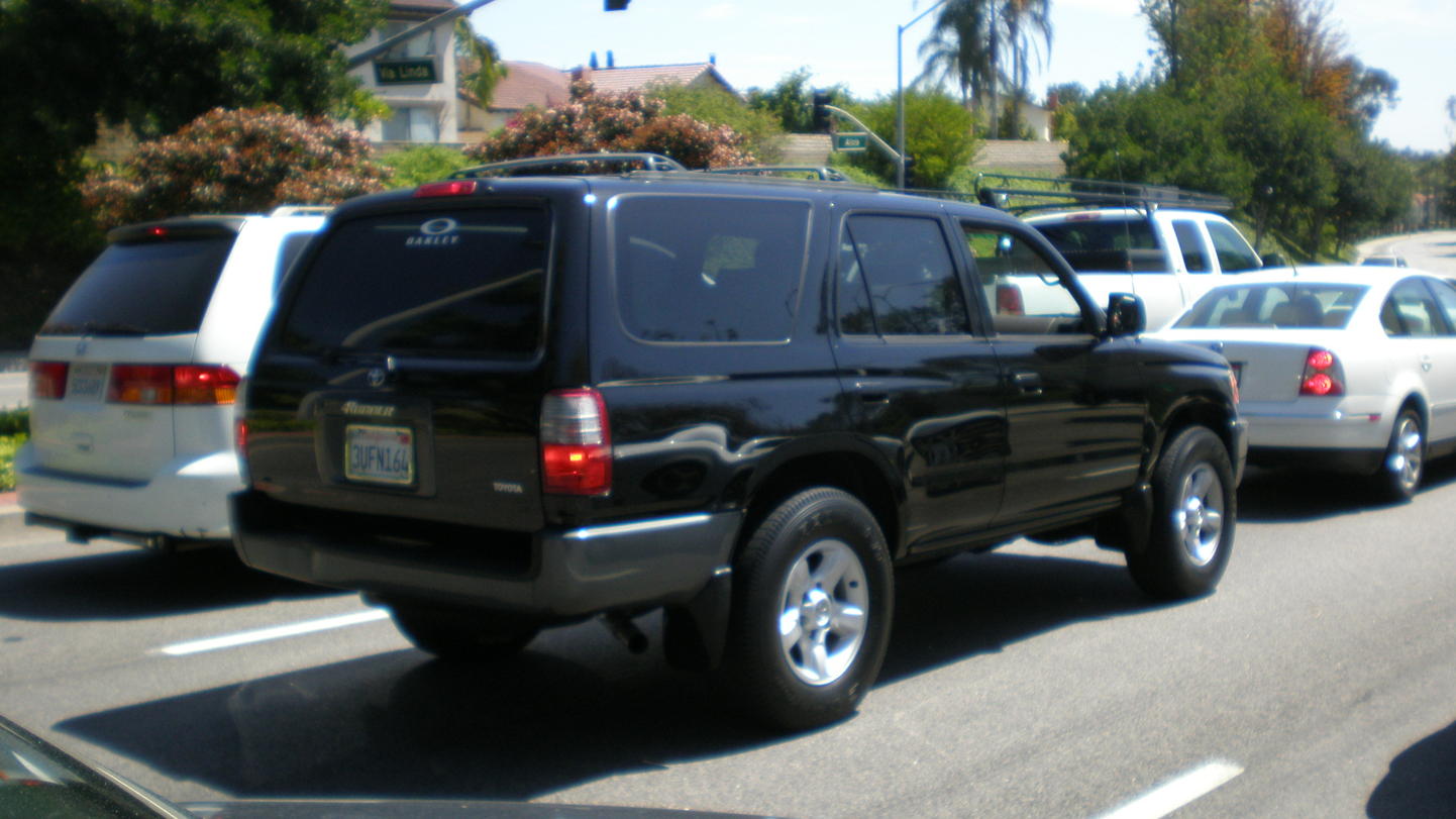

Man, I saw a 4Runner that looks EXACTLY like your avatar yesterday, only without running boards, sorry, don't know why camera focus didn't work
