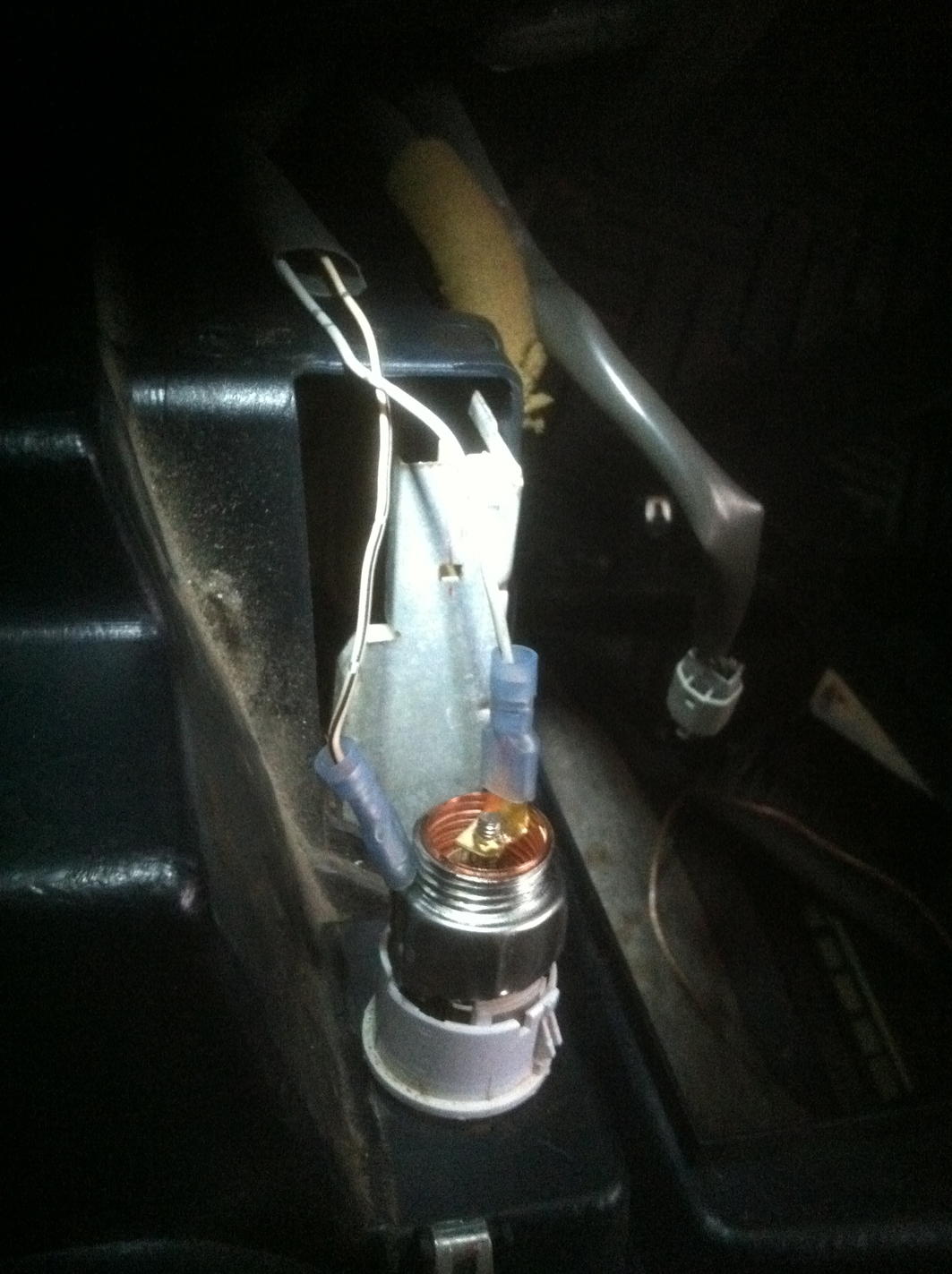

Every time I engage the cigarette lighter I blow the fuse shared with the CD/Radio. Do I have something mixed up?
By the way, it's an aftermarket replacement.

did you try different devices, phone chargers ect?
does the fuse blow with no device connected?
Also, I recommend you throw some tape around the exposed areas.
Thanks Brian. No, I've only tried the cigarette lighter. I will try GPS (the only other device I use) and tape around the connections.
Is it an actual cigarette lighter coil that you're heating up? That sucker will draw between 10-20 Amps. That is not what that factory circuit was intended for! You should run a new fused circuit from the battery to run that.
You didnt swap the ground and power did you? And x2 on electrical tape or shrink wrap tubing.
Nope, White/Black is the ground. But x3 on the insulation.
