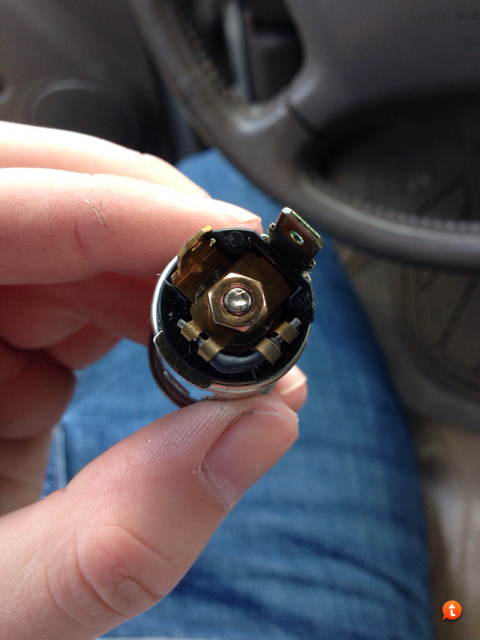

Upon testing the connector, there is no power getting to this either. So the issue is somewhere between the connector and the fuse. Any other ideas of where it could fail? There is a relay it seems right next to the small fuse in the engine compartment but I have no idea how to test it.
Yeah, that fusible link is intact. (It's that black "L" shaped wire.) Unlike fuses, they deform pretty dramatically when they go.
Most of those simple relays can be swapped with another to test. Just look for one the same size, compare part numbers, and swap if they match. Try to pick something non-essential to swap with.
Personally, I would build a system for the vehicle that has the capacity to work under load. The power outlets in most vehicles are for the smaller lighter loads such as a cell phone charger or lighting of some sorts. I would run a heavier gauge wire from the battery to the area that I wanted to plug a compressor into and put in a heavy duty circuit breaker (at the battery), just like I would if I were going to wire in an amp for a stereo system that has some capacity. Then connect the compressor to that wiring using a heavier duty type connector than a standard power plug. That way, when you are knee deep in snow, mud, or whatever yuck, it will do what you want it to. Remember to use grommets when going through the metal walls and make sure that the connections are solid.
If you notice the left end of the fuse-link it is wider at one point. try peeling the cover, I think the connection is melted inside it.
