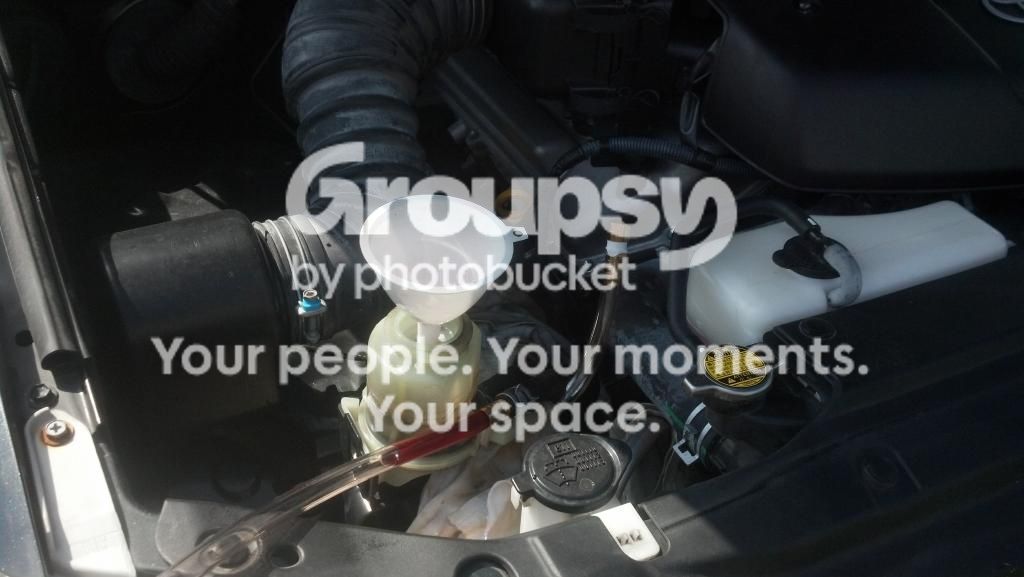

Here's a pic of mine when I did it last summer:
IMG_20140903_154041_147_zpsk9degoqg.jpg~original
Here's a link to the method I used, see Ken4's post:
Changing Power Steering Fluid - advice needed - Toyota Nation Forum : Toyota Car and Truck Forums
So, yea... super easy, several write-ups... I felt a lot better after I had the pretty red fluid in there.... :) I used the same size tubing as the TN post. I remember wondering if the hoses might be different between a car and a runner. They were the same. Oh, and I got a fluid pump from starbucks for free. I asked if they had any old flavor bottles I could have and they just gave me 2-3 brand new pumps still in the wrappers. Apparently they get tons of them for the flavor bottles... FYI. I used Valvoline Max Life ATF
