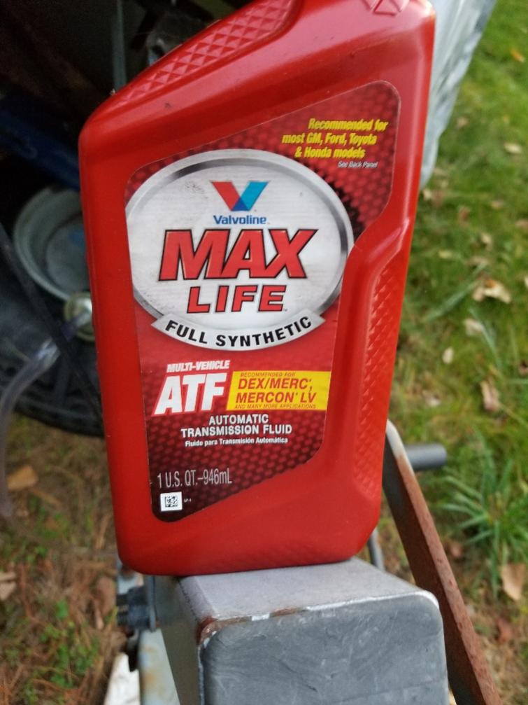

what p/s fluid are you using for the exchange? 4th gen 4runners call for dex2/3. not universal power steering fluid.
Valvoline Max Life Full Synthetic ATF
