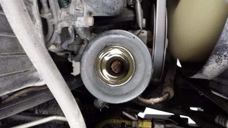

I started the truck and checked the fluid, it's foamy/bubbly. I also sprayed some soapy water on the belt, no change in noise. See attached pic

Cleaned the pump, fixed.
Looks like I spoke too soon. I cleaned the filter in the reservoir and the power steering worked perfectly. No noise and drove great for about an hour last night. I started the truck up this evening and the same symptoms are back and there's no power steering. What could this mean? Is it likely the filter is clogged again?

Also, after driving it without power steering yesterday for a few miles I parked it in the garage for a couple of hours. I came back out to look at the steering system again and started the truck up. To my surprise, I had power steering again and no noise from the pump. I didn't do anything other than let it sit. Could this be temperature related? This morning it was 20 degrees in the garage.
Last night I once again vacuumed the filter screen but instead of leaving it in place, I punched holes through it. Problem solved. Pump is quiet and power steering works great. I'm guessing the screen wasn't allowing the fluid to flow until the fluid was warmed up. I refilled with the same cheap fluid. I may install an inline filter but after dealing with this for almost 4 weeks, I'm going to take a break.
