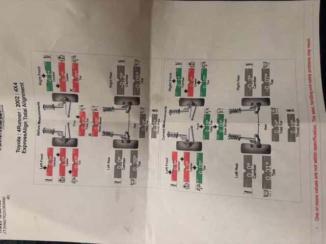

Camber and caster were frozen/un-adjustable by firestone but did not change when when I replaced the steering rack PS pump etc. Thanks for the advice I'll try jacking it up and moving the wheel lock to lock several times with engine off.

By those numbers, isn't your caster practically backwards?
Would that not explain the tendency to just keep tracking
on it's last trajectory rather than return-to-center?
I mean, yeah that's maybe a little exaggerated, but I'd say at least
bleed the system properly, get a sawzall, and get those cam adjusters
back under control.

Also, is it lifted a bunch?
That practically-zero caster seems like a big susp. lift
without any UCA correction for the new ride height.
As ghostring said, replace those cam bolts, and get it re-aligned. And possibly look into front upper arms (they are pricy) but give some correction for caster.
