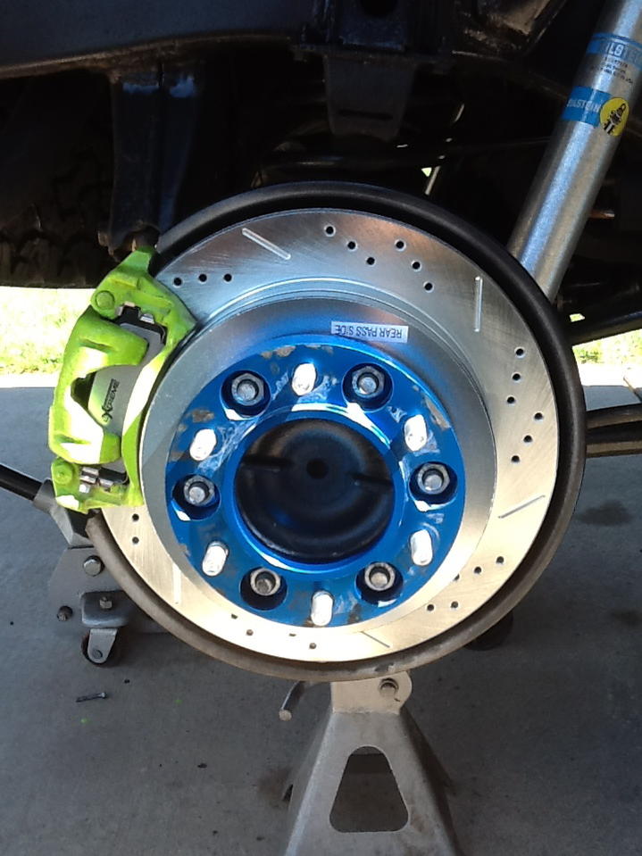

New Rear Brakes
I did run into one problem which involved the parking/emergency brakes. The new rotors did appear to run a slightly smaller internal diameter, so the brake shoes rubbed badly. Soooo, I had to remove the new brakes, adjust the "star" adjuster to bring in the brake shoes,...still rubbed,...had to get in under the console to get to the brake cable adjustment. It still rubs a bit, but not bad. I am hoping the new rotors will eventually just remove the pad material and it quiets down.
I wonder if I just need to do a rebuild kit on the parking/emergency brakes with tighter springs to hold everything in better.
I just had it out this morning to seat the pads. No noise and it feels a bit firmer on the pedal.
At any rate, if anyone plans on using these aftermarket rotors on the rears, it wouldn't be a bad idea to just do a parking/emergency brake rebuild ($20 hardware, $20 shoes).
