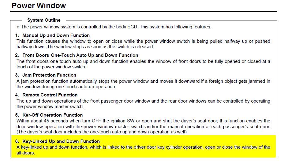

I was looking through the wiring diagrams for my 4Runner's power windows, and noticed something. After all the diagrams, there is a system outline, with notes on operation. The last note is for "Key-Linked Up and Down Function" and goes on to say "A key-linked up and down function, which is linked to the driver's door key cylinder operation, open or close the window of the all doors". Regardless of the typo or poor english, this is something mine doesn't do. Has anybody else tried this? Does it work on ANYBODY'S?
I checked 2003 & 2004, but don't have any other year 4Runner diagrams. I think this would be very cool to have operational.

Noticed this in the manual back when I did the constant power to the windows by pulling the relay. Doesn't work like that on any 4th Gen. I think it's a cut and paste error of a generic page while drafting up the manual that got past the reviewers.
Yeah, that's kinda what I figured. It had to be too good to be true. This would make it much easier to have window roll-up with aftermarket alarms as well.
