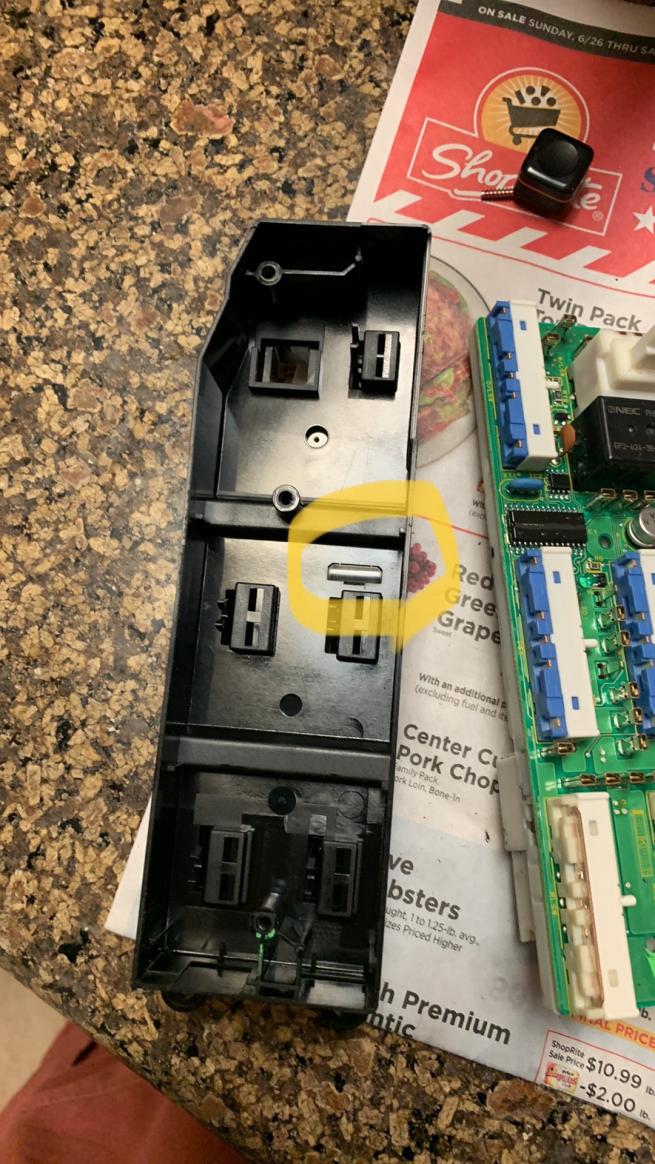

I took mine apart last night to see if I can get all 4 buttons glowing. I noticed that the older models (mine is an 01) and mine have completely different motherboards and switches.
My panel backing has one clear lense which I highlighted in yellow. So it's the only button that will light up green, the other 3 don't shine up at all. It makes zero sense to me why 1 out of 4 buttons would be like this?

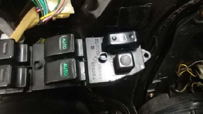

Thanks Brillo, so you are aware about all the buttons not illuminating? I'm with you as it's totally beyond me.

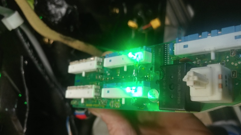

I added led's to mine. Passenger side had me scratching my head though. Turns out that the light goes out when you hit the window lock button.

Worst case...you can run a dash light wire over through your door boot and Illuminate with it.

The reason Toyota didn't backlight them all is cost. The cost of adding a backlight plus more complicated window switches was not something that Toyota thought was necessary. The PCB design would also have to be more complicated to allow for extra LED, and then that adds to BOM.
Even if I soldered in 2, my backing still does not have the clear lens for it to illuminate.
On my 2002 just left rocker illuminates. On the right one you have to drill a hole under the lettering to let the light thru and install a clear lense to focus the light up. If you take off the switch rockers you'll see what I mean.
