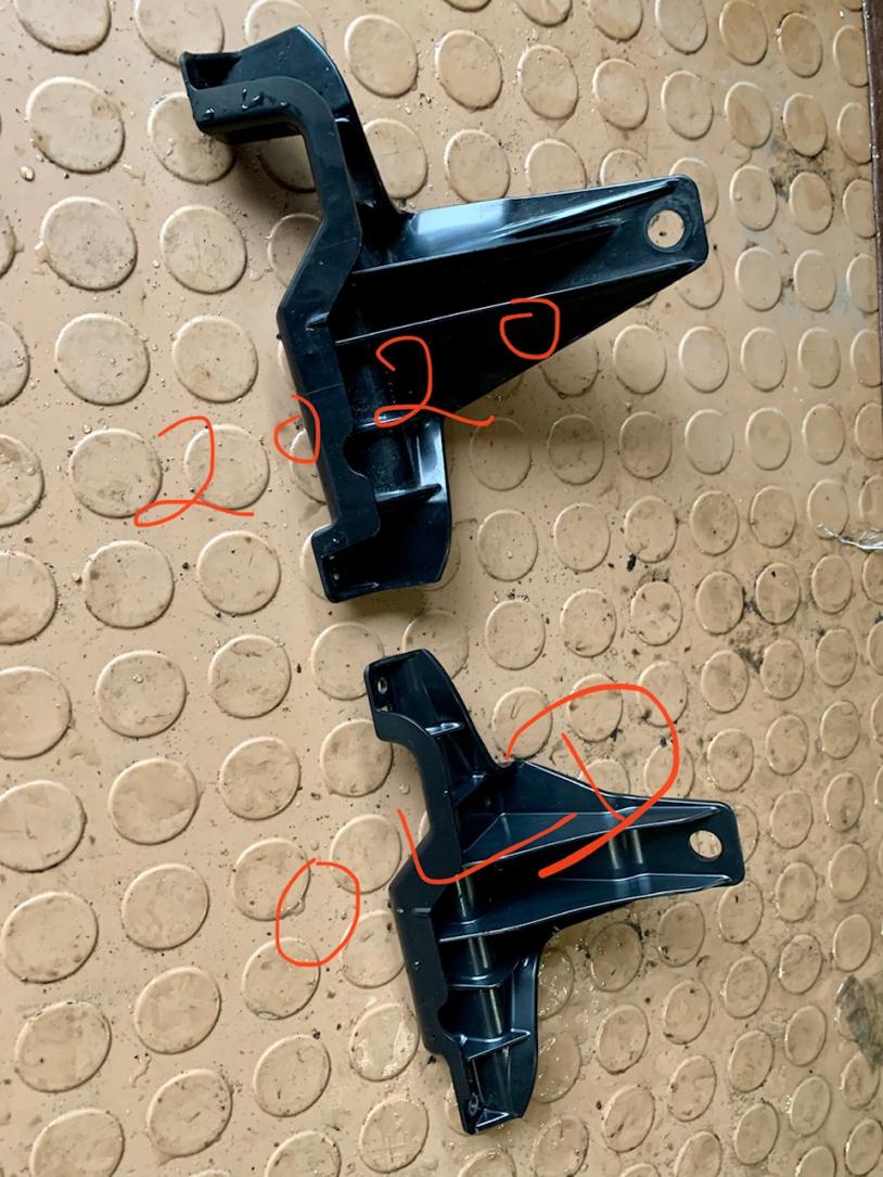

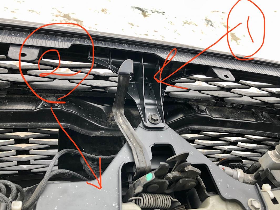

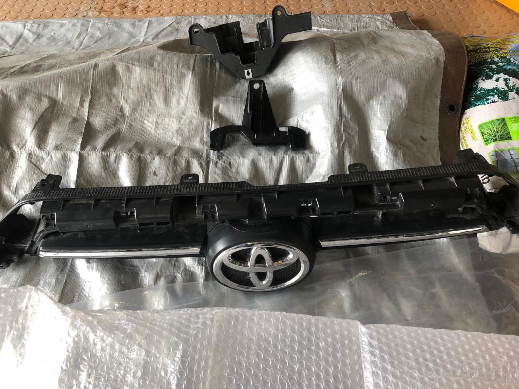

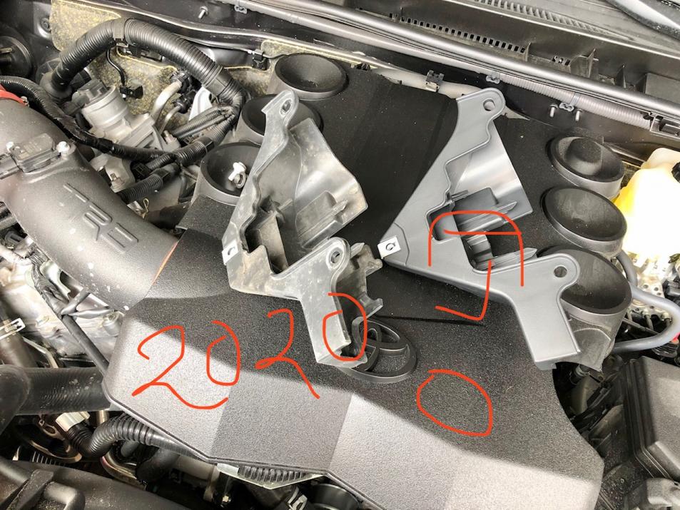

on top of trimming the long black nameplate plastic part a bit for the TSS sensor, you will need to do two mote things
(1) cut two or three tiny holes in the bumper wherever the GRILL's locking tabs don't lock into the bumper. i did this with a sharp haxoknife. very easy
(2) buy two brackets if you do not want to do custom cutting of the radiator grill bracket. parts 53115-35050 and PZ327-35701
attaching pics for reference

Additional parts required for install on a 2020 using 2019 and before TRD PRO Grille
Radiator Bracket - 53115-35050 $41.43
Radiator Bracket - PZ327-35701 $28.35
or
2020 TRD PRO Grille
Garnish Front Bumper - PZ323-35058 $287.92
Grille Radiator Up - PZ327-35056 $113.59

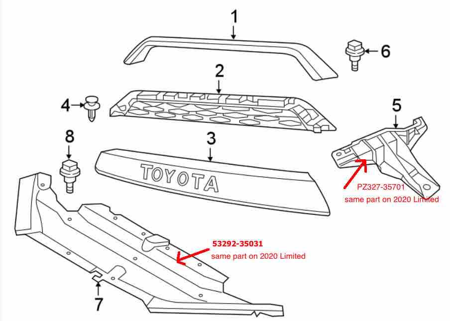

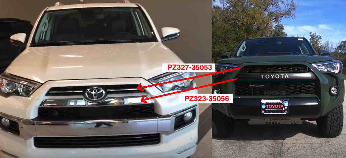

2020 TRD Pro grill to 2020 Limited
Hello. I'm creeping an old thread here. I cannot seem to find any solid info on this anywhere (I know, everyone says that).
I have a 2020 Limited. Does anyone know if the 2020 TRD Pro grill would be an easy (no cutting) swap? It seems the 2020 Limited shares the same bracket components as the TRD Pro (pls see attached pictures). But surprisingly I am not finding any info out there of anyone doing a 2020 to 2020 swap from a TRD Pro grill to a Limited. Cheers.

Anyway, these are the only parts you're going to need if you're staring off with a 2020 which means you won't need to mix and match pre-2020 parts.
PZ323-35058 Garnish Front Bumper
PZ327-35056 Grille Radiator Up
