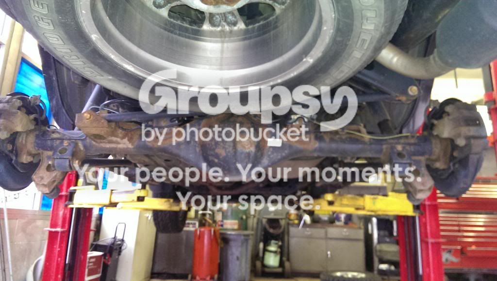

Here's what the frame rust on my '06 looks like. I'm in New Hampshire, for what it's worth...salt central:You could ask the dealership to check the calipers to make sure none of them is seized because that seems to be a problem both V6 and V8 4Runners are subject to, but otherwise I'd be pretty confident with your purchase.
Here's the first one of the rear axle from the back. I think it's the worst looking and I'm going to need to figure out how to arrest that rust somehow.
IMAG0101.jpg~original

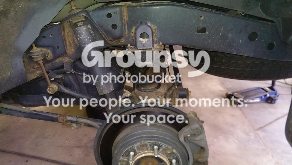

Here's the driver's side rear wheel well; not too bad for a New Hampshire-based '06:
IMAG0105.jpg~original

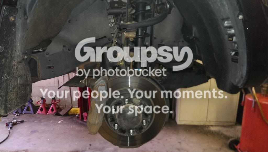

Last one here is the passenger's side front wheel well:
IMAG0106.jpg~original
I haven't looked at the frames of too many comparably aged vehicles, but I don't think this is too bad for a truck going on seven years old. I'm open to people's thoughts on whether or not I'm right about that, however.
