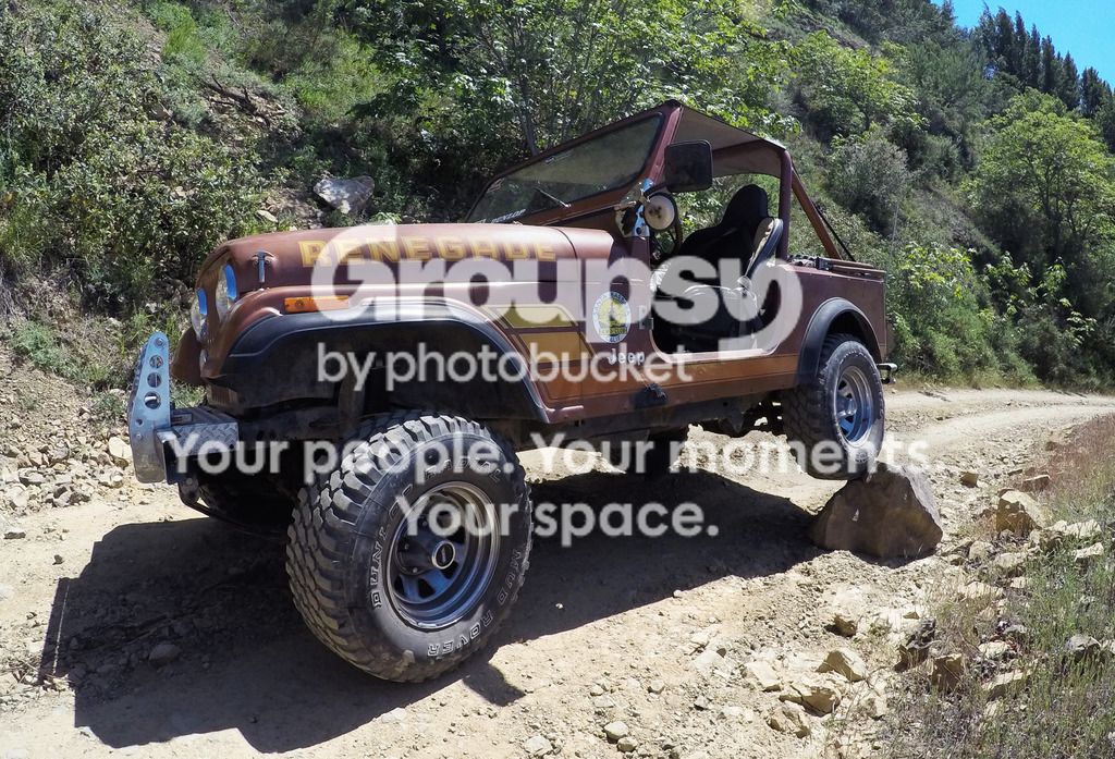

I have a 4x4
It's plenty capable!
jeep2_zpsacxz0yxy.jpg~original
I do need a good, reliable family carrier that will get me out to the desert and back for camping etc!
