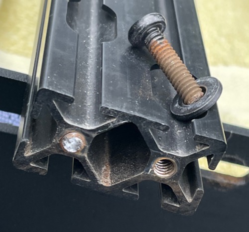

Hello.
To my dismay I have found out that most of the cross bar bolts are rusting. One bolt sheared off as I was trying to make adjustment to the bar's position and I have no idea how to get that bolt extracted without taking it into a machine shop.
I have written to Prinsu about it and am hoping to hear from them soon. I wonder if others may have experienced rusting and how you dealt with it, and if you have suggestions on how to get the sheared bolt extracted.
Thanks a lot.
Farzad

Screw extractor. And then use anti seize on the bolts Dis similar metals corrode way easier. Being steel and aluminum

This is the problem with dissimilar metals especially aluminum and stainless steel. The aluminum most likely expanded due to corrosion and is gonna be a SOB to get out. If it was me I would undo all the screws I could. Spread the sides of the Prinsu rack out and remove the cross bar. Heat and beat with a hammer to loosen bolts and hopefully there is enough room to get vise grips on the broken off heads threads.

Should be an easy enough job to extract that broken bolt with a few applications of some penetrating fluid and a screw extractor set, which can be found at at local hardware store. If that fails, just find a drill bit slightly smaller than the bolt size and drill the broken bolt out.

Heat. Aluminum expands crazy some heat should separate the metal and rusty threads. Might have enough exposed to tack a bolt on there, giving you a place to turn and heat at the same time.

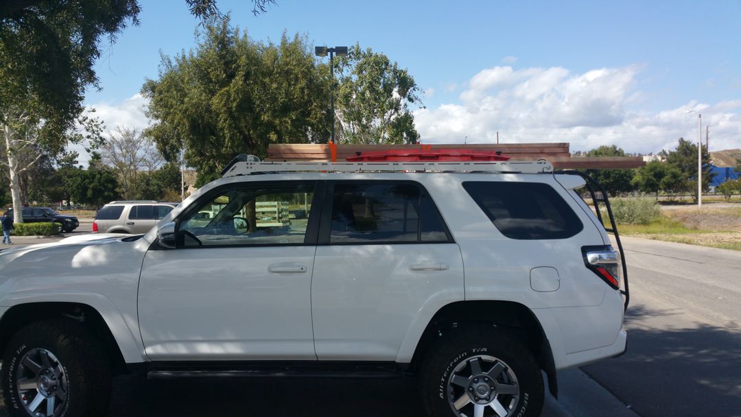

The original Prinsu designer sold out his designs to another company soon after I bought my rack. I was one of his last customers. I will say he was very on top of the quality. I have no say on how it is since.
The all aluminum design was made to save weight but is also pretty strong. There are between 8 and 11 crossbars depending on your setup and with 4 bolts for every one it spreads out the load pretty evenly.
I have thrown up a lot of weight on mine over the years and it has never let me down. This is the only picture I could come up with which isn't much but it has held much more.
Sherpa uses stainless hardware that come in black oxide finish and their prices are good. You could buy replacements from them if it's the same size. I've never had luck heating bolts stuck in aluminum, it's too effective a heat sink in my experience, but would also recommend a screw extractor and lots of liquid wrench over several days. If you have a welder you could also weld a nut onto the stud (after soaking stud in penetrant), but if you snap that the remaining piece will be tempered and even more difficult to drill out

Prinsu sent a replacement part almost immediately. They acknowledged the issue and stated that some customers replace the stock bolts with stainless steel bolts as some of you have also suggested.
I am looking to get these bolts as replacement. They are 1/4" shorter than stock bolts and that only affects the amount of torque you can put on the hole threads since they are weaker than the stainless steel. However, I intend to test one of them at 30 ft-pound which is the tightness specified for the original assembly. I also intend to use anti seize during installation.

Anti seize affects the torque reading and will make it more likely to strip, and is unnecessary if using stainless. I used blue loctite
Doubt to where you'd notice but you could blow them out with compressed air or brake cleaner if you're worried. The surface insensitive Loctite is better for some contaminated surfaces
