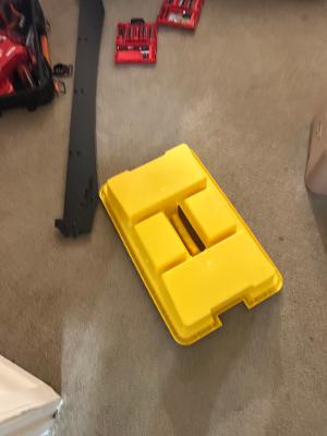

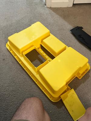

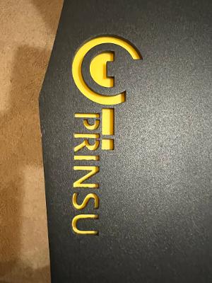

a bit off topic, but if you want to add a bit of "flair" since you are in the middle of installing..lol.
