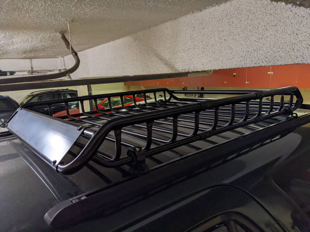

With the current Harbor Freight roof basket (+5" off the factory tracks) and 265/75 R16s I'm at 77"

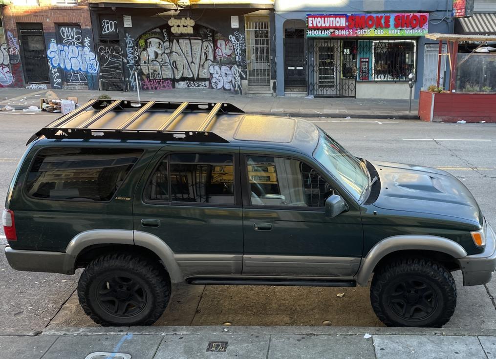

Just checked the height above the roof with Antero. Forward most cross bar is about center with the rear door, or about 6 inches behind the sunroof. 2.5" from the roof to the top of the bar.
I drove into a parking garage yesterday with 6' 6" warning sign no problem. 2" at most suspension lift/no body lift.
My question is why use an apostrophe on Bong's when you seem to know how to pluralize Hookahs?
