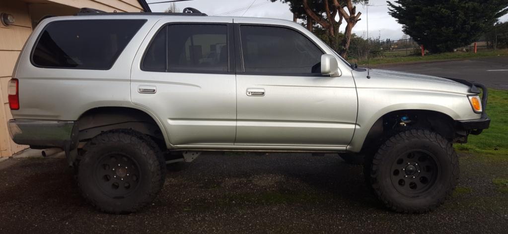

It's November and I finally have both time and funds to do some upgrades. I will post more pictures of the parts and status of the work as it gets done. Here's what I'll be doing:
UPDATE 12/04/16—Wheels, tires, and front turn signal lenses installed!
I decided to forego the center cap logos for now. I liked how Wheeler's glossy center caps and the Gorilla lugs went against the matte black wheels.

Good choice on the tires/wheels :wink2: that's what I ran for 2 years and ~30k miles, I have nothing but good things to say about it.
Have fun!

Hey, I know this post is older but I am wondering how those rims and tires worked out for you? I have the same colour 4runner and love the style of those procomps. Wondering if you got much rubbing on the inner fender, body mount or pinch weld.
