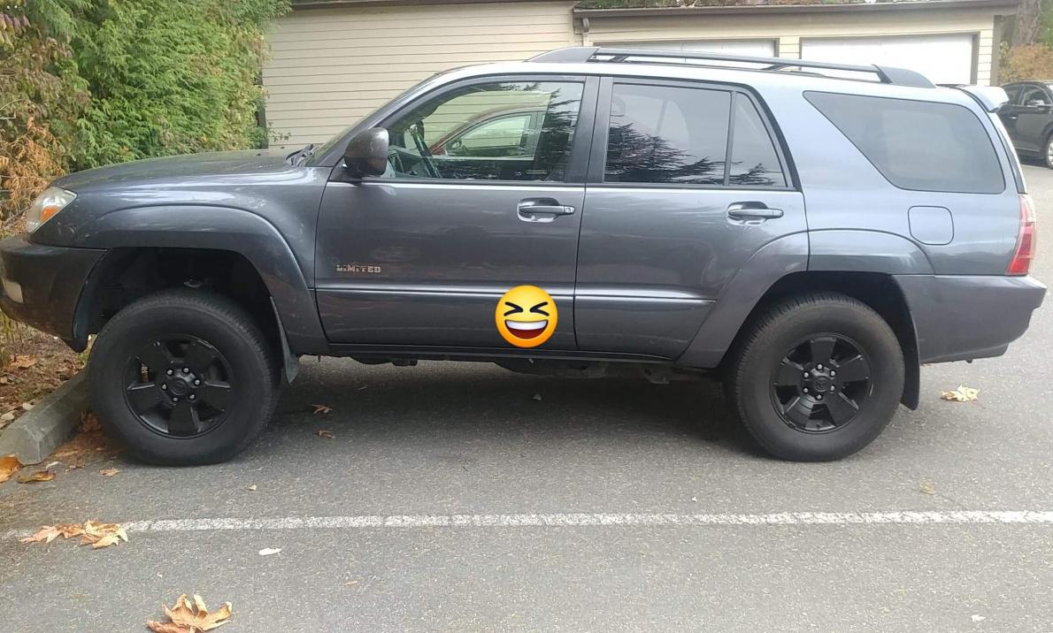

Once I started to jack up the lower control arm to compress the spring, I could never get the shock to protrude enough at the top. I tried all settings for the perch and even on the stock height setting I could not get it.
I ended up switching back to the stock coil and was finally able to get the top nut on. However, once I got it all buttoned up and lowered the truck back down to the ground, the springs never compressed enough and the truck has about a 4 inch lift in the front. On stock springs, I do not think that's a good thing.
What am I doing wrong here? I haven't heard of anyone else having this problem. It seems like a very common job.
Here is a pic of what it looks like now on the stock springs, 5100s set to stock height...

I may be mistaken but if one of the parts (don’t remember which one) is upside down, this is the result. I’ll look for a thread and try to post. In the meantime post photos of how it’s assembled to see if someone with the same stuff can confirm it’s correct.

I just did the same install last week and had no issues. Can you post a pic of the shock/spring configuration?

Sounds like the spring perch is upside-down on top of the height clip. If I remember correctly you will not be able to see the clip when the perch is installed correctly.
Hey guys thanks for the quick responses.
Noobie mistake, it was that the spring purchases were upside down. Able to get the Moog springs in after all.
