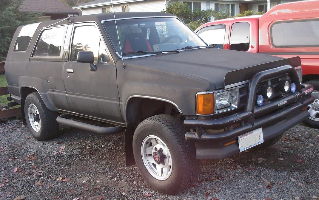

Thanks for the suggestions! My hubby is already out there sealing the windshield with Gorilla tape. We are going to cover it up to protect it against further rain while we figure out what to do with it. It was running fine until the latest big rainstorm with lasted a couple of days earlier this week. I will post some pics if I can figure out how to do it here.
It is dull black because the PO rhinolined the exterior instead of repainting it. Also, it was originally an automatic, but he changed it to 5-speed manual a few years back.
