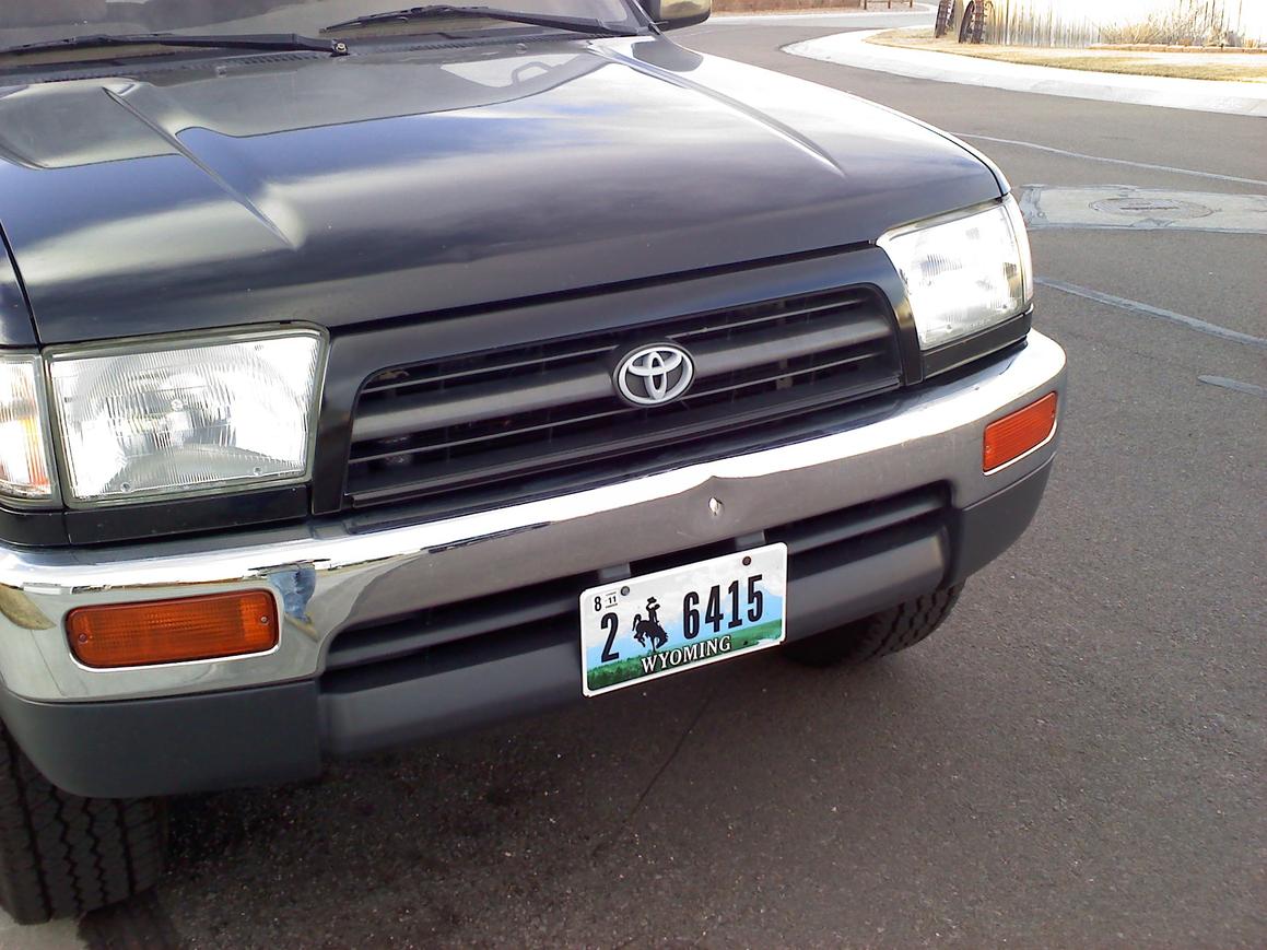

My grill cover in this picture was chrome until I painted it a few weeks ago. I just drove 1000 miles accross country going between 70 and 80 mph, and at one point had a ton of sand/rocks from a dumptruck splash my front end, and yet it chipped very little. Obviously prep is most important. But primer is vital too. I did three layers of self-etching primer, three of paint, and two clear coats. Even in the small paint chips I have, the primer is still there. Only the paint and clear coat chipped off. My grill cover has a layer of chrome, and I sanded it rigorously before painting. But I didnt sand through the chrome, and its sticking pretty well. And I think part of the reason the paint chipped off is because it was about 40 degrees when I painted it. Im thinking once it warms up im gonna sand it down and re-spray with paint to match my color code.

Looks good, I have some color matched paint for my grill and rear plate bracket.
Just waiting for the spring to put the project in gear..
I dont think ill be lucky enought to get the bumpers to match so I thinking of doing black..
But Ill see how my grill and plate braket come out and plan from there...
