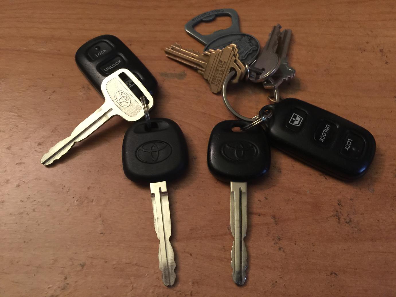

Programming your transponder key for OEM Toyota security keys.
Step 1: Cut your blank key
Step 2: Press and release the the GAS and BRAKE peddle simultaneously (at the same time) . . . . ****do this without the key in the ignition
Step 3: Insert the working (master) key into the ignition and press the GAS pedal 5 times within 15 seconds of inserting the key into the ignition
Step 4: (With the key still in the ignition) Press the BRAKE peddle 6 times. Do this within 20 seconds of completing step 3. Then remove the master key (the working key)
Step 5: Insert the new key and press the GAS peddle once.
Step 6: Wait for the security light that blinks to stop blinking (could take up to 2 minutes... took approximately 20 seconds until mine stop blinking.
Step 7: As soon as the red security light stops blinking remove the NEW key and press the brake peddle once
TEST to make sure your new key is successfully programmed.
It took me 2 attempts to successfully program.
DO NOT rush the steps but be mindful of the time intervals between steps.
It doesn't have to be fast, just precise.
I pressed the peddles relatively firmly my 2nd attempt.
I purchased my chip key/transponder keys from eBay, but i cannot guarantee that this will work for all 3rd party keys bought over the internet.
these eBay chip keys are hallow feeling and i wish i had an OEM transponder key that felt a little more substantial and hardy. you can definitely tell the difference between the two keys.
keep in mind i have an OEM toyota security system (not a 3rd party security system like CARR for example) in my vehicle and will not take responsibility for any mistakes made during this process.
*****TRY AT YOUR OWN RISK******
i cannot take credit for these instructions either. found these instructions on youtube and believe they work on most toyota's with transponder keys from 96' and up although i don't know the cutoff year...

So, [MENTION=102606]infamousRNR[/MENTION], the metal key in your picture can't be used to start your rig? What's the point in having a key that won't start it? I guess that would be the ideal situation for a Hide-A-Key. Does anyone do that anymore??(in the generation we live in, I feel like I need to say "don't post online if you happen to be someone who DOES have a Hide-A-Key" [emoji23]*♂️)
Any of them offered with factory security should have the transponder key. 99-02 Limited for sure. Couldn't tell you about 96-98.
