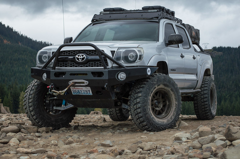

Picture of said Tacoma... Check out the new 16" SCS Stealth 6.

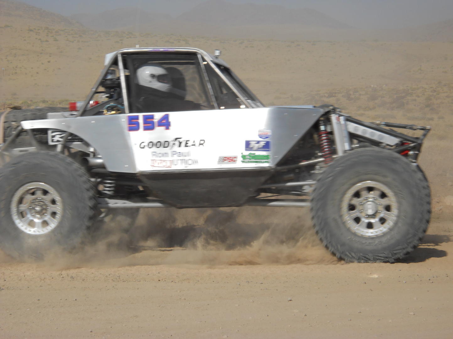

Then there are the Ultra 4 cars that are SA at both ends. Now that takes some effort to make it work right.
