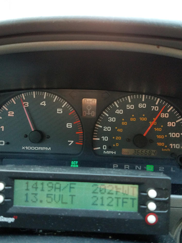

Any thoughts on this would be greatly appreciated. Here's a few pics:

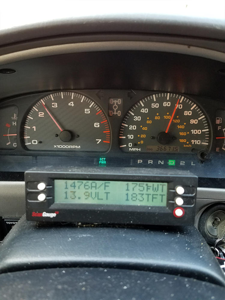

Here's where I was yesterday afternoon just before getting off the freeway to head home. Pretty hot and I had the AC on full blast. I also just had to pass a couple of trucks and quickly get into my exit lane. About 30 miles driving and in traffic.

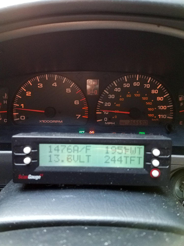

Top of my 3 mile climb just before entering my private drive. Drove up hill with the AC off and OD off. It cools down very fast.
Here's where I was at this morning after a 25 mile drive. For the most part, once it was warmed up, it stayed around 179 - 183 most of the way.

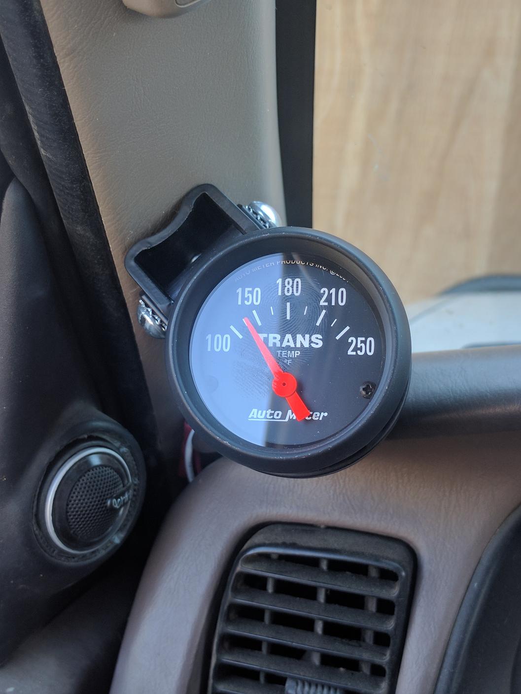

Well, I do care about my 97 so I put an Auto Meter gauge in when I added the trans cooler in-line with the radiator. Simple and worth it for the piece of mind alone. But if you trust your idiot light that's cool too.
