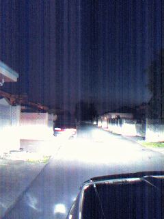

It was really easy to put it. It was a direct fit. Everything was perfect. no drilling, no splicing, no nothing. realy easy,. it took about 1.5 hours. here's a picof what it looks like on low beam at night. sorry about the low quality pic, i don't have a digital camera

looks good. but do you think it'll blind someone though? also, where you get your HIDs at? :D

you will blind the crap out of everyone on the road with glare unless you have some sort of shield on there, aka the casper shield, i modified mine to not let glare out. if you can see the capsule of the bulb from outside the headlight housing, that is glare escaping.
read up on www.hidplanet.com/forums
dont post a pic or you will be flamed.
