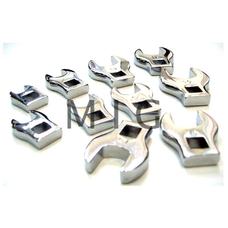

Crow feet. Very handy little tools that should get you in there with an extension

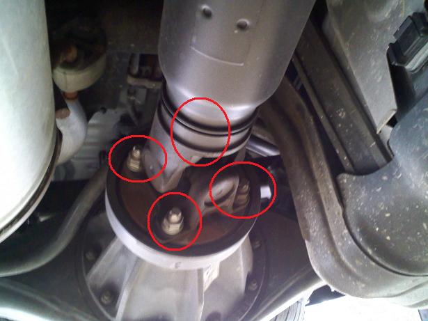

It's actually the nuts at the ends that are torqued and iirc for 3rd gens it's 54 ft/lbs. . . can't find 4th gen torque specs

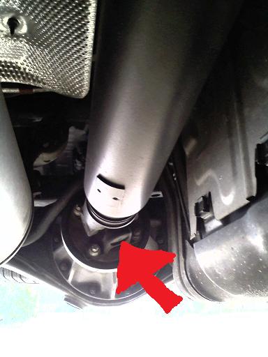

Yea every 10-15K miles they ask me to tighten it. At the 20k Mile mark I was towing a cross-country trip over 7K miles so I went ahead and paid out the $40. Ill pop my head under the 4runner today and look for some nuts.
I think I found them (circled them in red). If this is really all they do at $10 nut, I will be very upset.

As far as I can tell, I think a traditional socket will work on the nuts. It will probably need to be an extended head though because the bolt sticks out.
The problem is not getting a socket to fit, the problem is the clearance with the head of the torque wrench. That's why I recommended the crow feet. That should off set the torque wrench from the drive shaft allowing you to ratchet down
