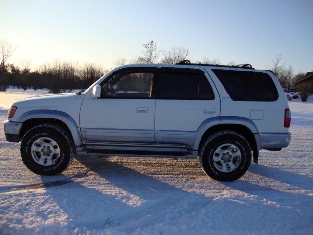

Hey all,
Just traded my 1995 SR5 for a 1998 Lmtd. The '98 has high miles on it (204k), but was well maintained with excellent records (as shown in pictures). I was wondering if there's anything that i should be concerned about as far as the longevity goes, i would love nothing more than to watch my truck roll over to 300k. Help would be greatly appreciated.
