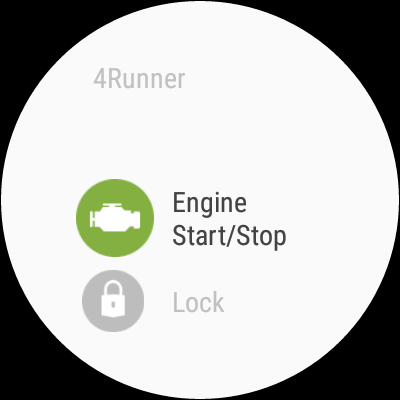

Thanks to Steve I can now start my 4Runner from my watch haha.
Steve is a pleasure to work with. With his guidance I'm pretty sure
anyone can accomplish this install.
Thanks again Steve, appreciate it!
