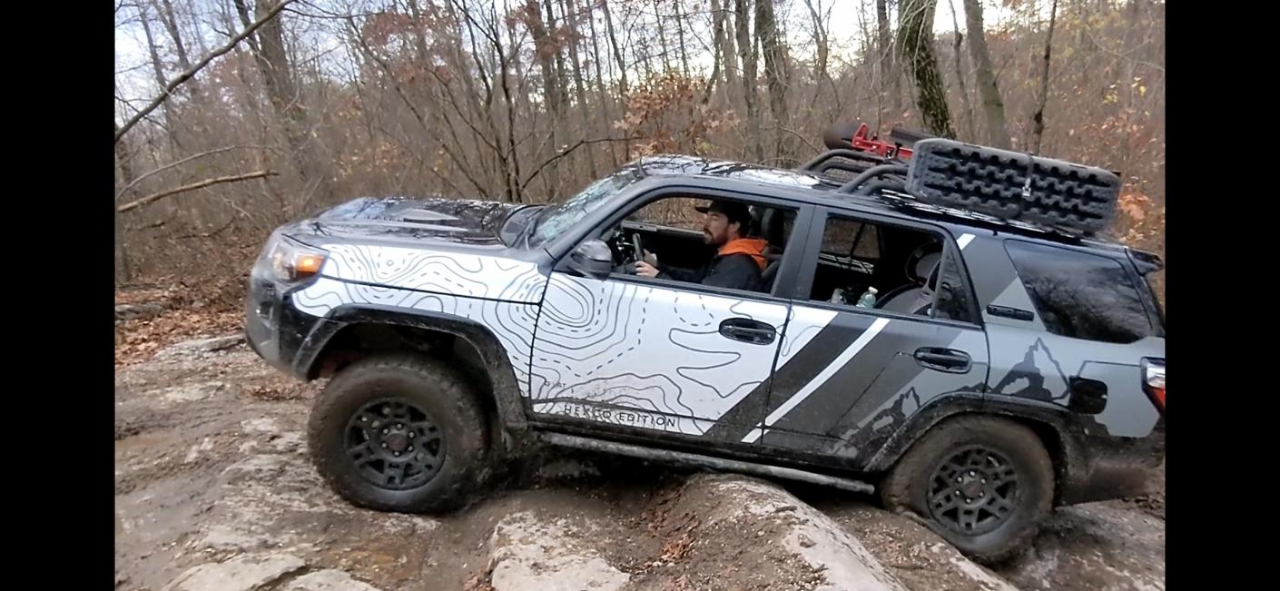

I do 14-15psi when rock crawling but my C load KO2s have taken quite a few gouges into the sidewalls and they can get pretty pancaked on impacts. I found the traction was best at this psi.
