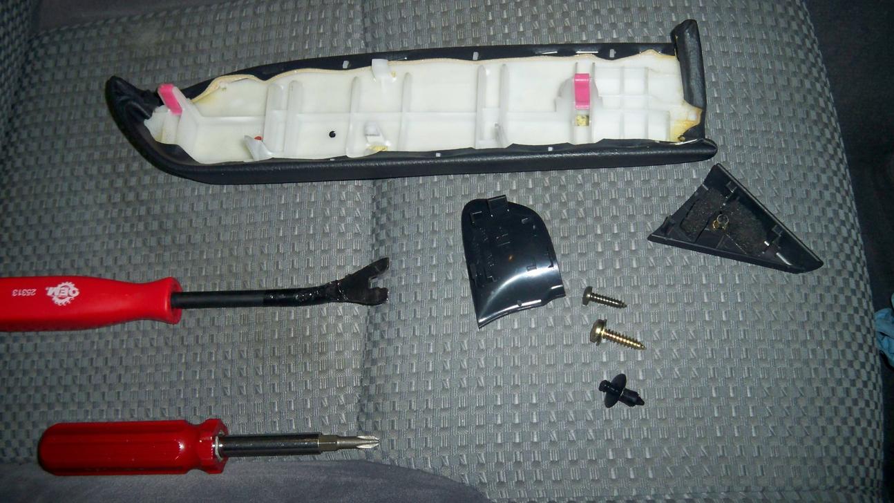

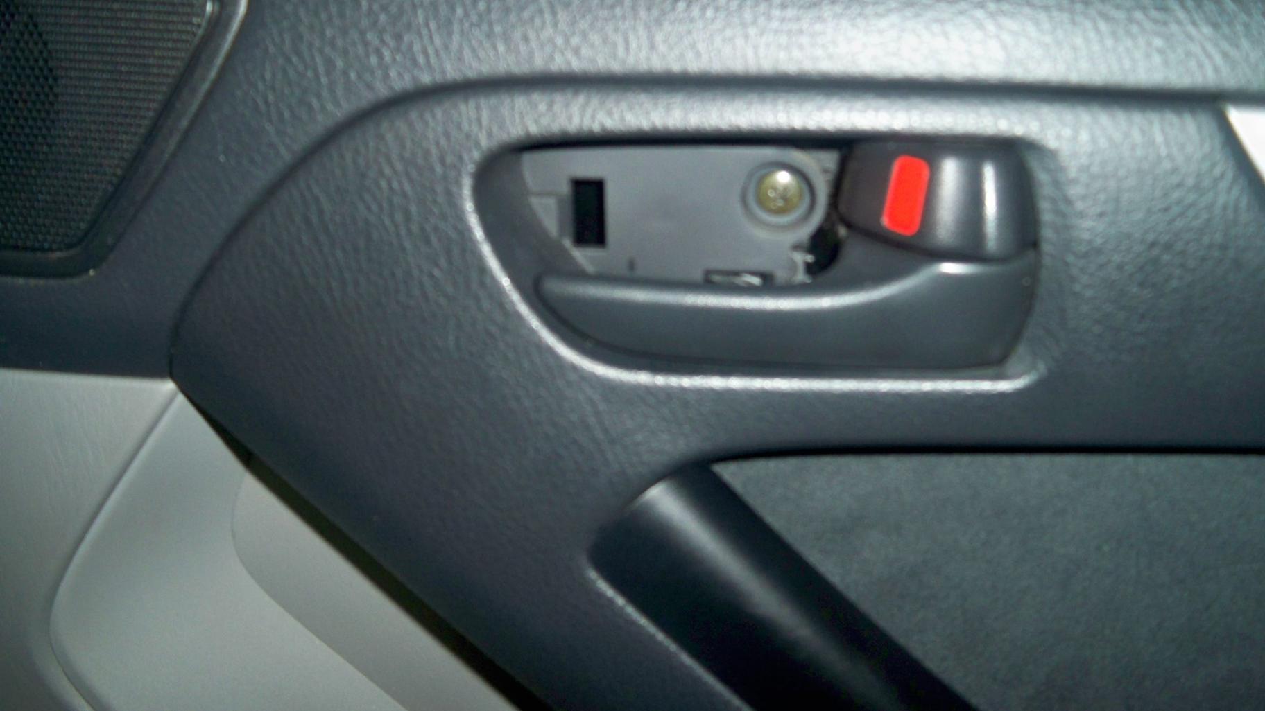

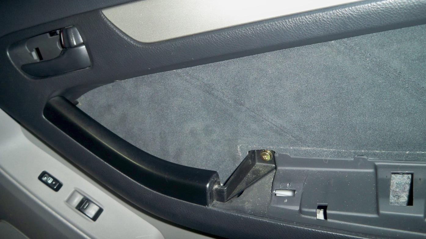

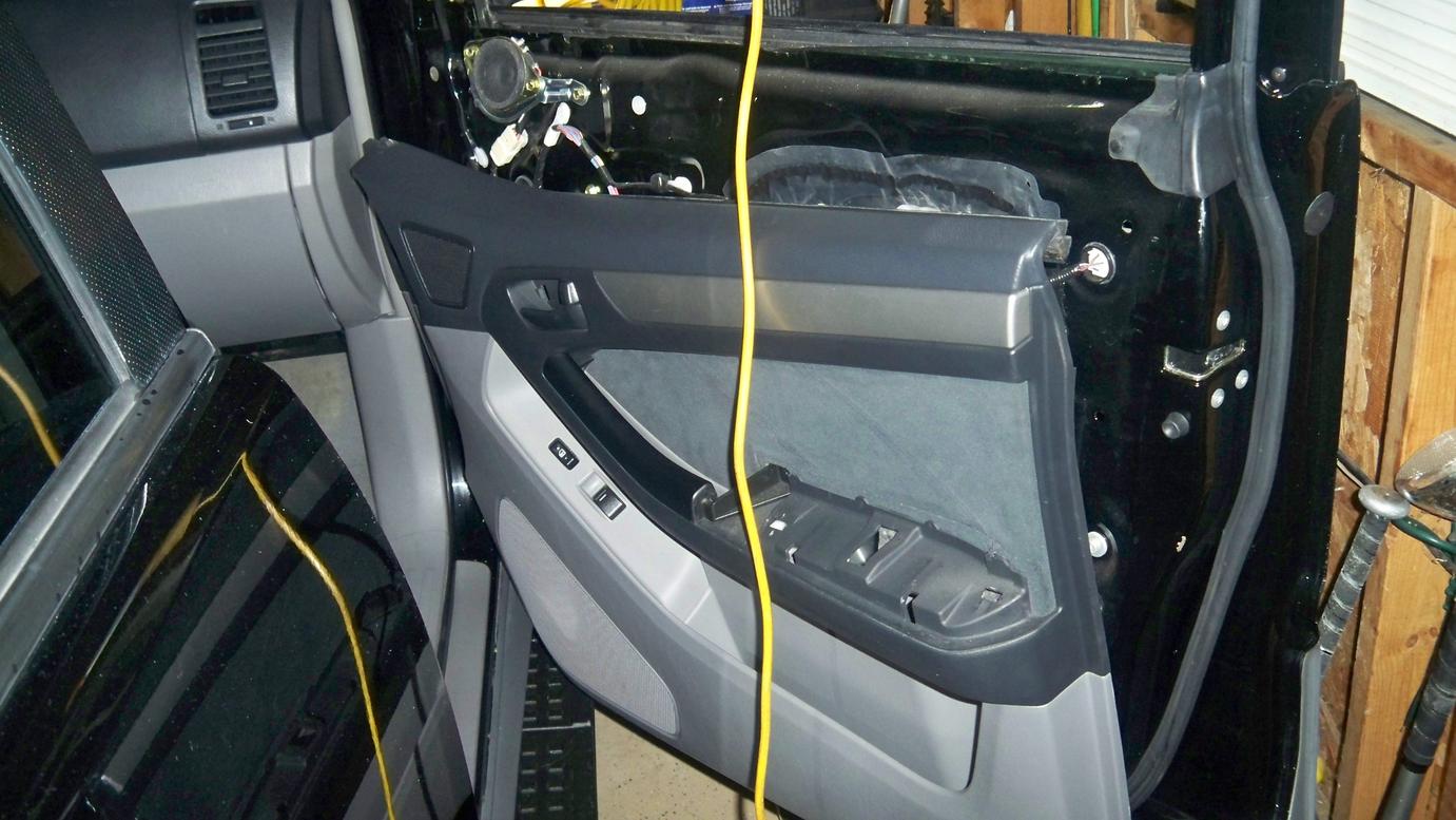

Pretty easy job, nice quality clips that don't break when you pull them apart. A proper prying tool helps. Two screws, one under the lock/door handle, another under the arm rest. After popping all the clips, and removing the two screws, lift the door skin off.
I found a connector disconnected, now I have speakers again!

It was clean, looked very nice. It's not the original door, this car had an accident at 3-months old, which is why I got a screaming deal on it a few days ago. I wonder if these speakers haven't worked since then? They used all Toyota parts, looks like everything was well done.
