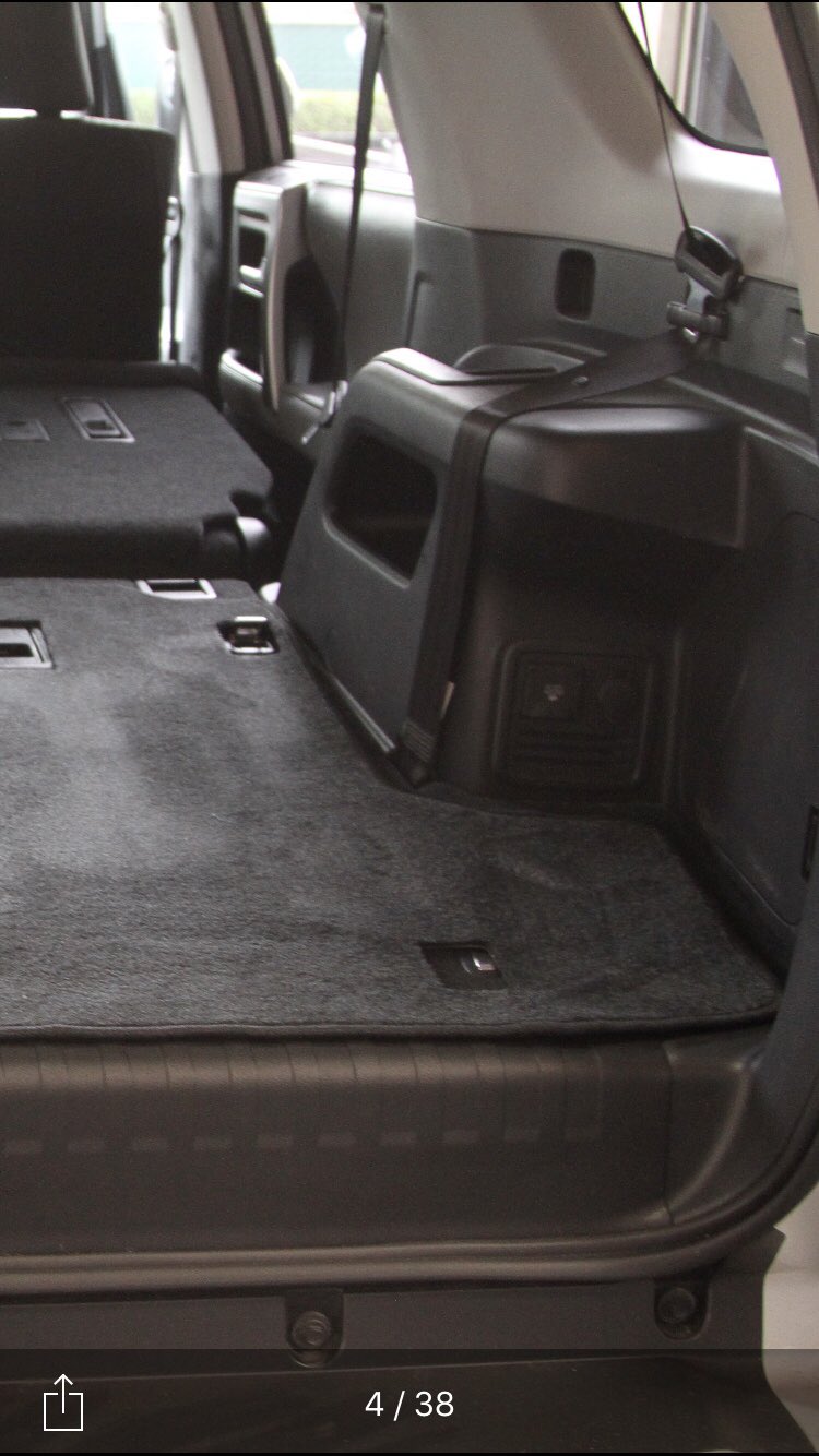

Hi All, new to the forum!
I purchased my 2011 limited about 2 weeks ago (traded in my 08 Prius). I basically need to haul a bunch of film equipment and a 5' Magliner cart and wanted to get a flat cargo surface but the dealer only had the limited with the 3rd row option. The sliding cargo tray option looked impressive but they did not have it in the model i wanted. Another issue I have is that the back seats don't fold down flush like the models without the 3rd row.
So today, I decided to remove the 3rd row seats. Removing them took about an hour. I worked my way from the back to the front - removed the covers and unbolted the seats. They came off pretty easily. The two 3rd row seats are pretty heavy. I am glad to not be hauling that much excess weight around anymore. I think I also gained about 7" of vertical cargo space in the back.
I was wondering if anyone had some ideas on how they might approach the flooring for the cargo area. Would you simply have it carpeted, place a stiffer surface and then carpet it, or build a lower cargo shelf and then build a stiffer surface on top of that for the heavier and larger items. The last option seems more practical to me as I can roll my cart all the way in and have the cargo area somewhat level to the back seats when they are folded down.
I have attached some images from the 4runner. Lastly, anyone interested in some 3rd row seats?
The Prius was wonderful but I really love the power and the feel of the the 4runner. I always felt like I was overloading my prius with gear. The next few projects I have in mind are: 17" TRD wheels, removing chrome, and a new roof rack. Looking forward to hearing from you.
