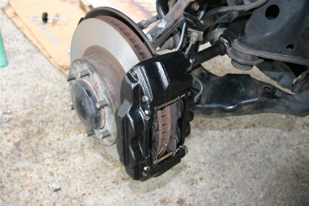

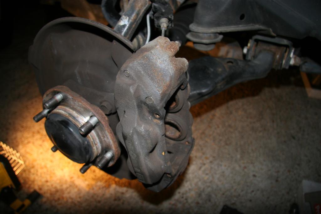

So lately I've been getting a pulsing feeling from the T4R during braking. I am thinking warped rotors or possibly a stuck/frozen caliper since it seems common on the 4th gens. So I take the front brakes apart, calipers are all rusty, some of the pistons seem REALLY rusty, so I just say screw it, go to see my buddy at Napa, get both brand new front calipers. Took the rotors to a local shop, the guy said they are within spec and turns them for me. So I get it all back together, new caliepers on, pads still have plenty of meat, bleed the system, clean all parts with brake cleaner, etc.
The pulsing is still there!!?!?!:wtf: Should i look at the rear brakes possibly? Just hoping to get some suggestions from some fellow T4R owners.
Here's a pic of the old and gross brakes, and the new setup, just cause i know everyone likes pictures.

I have pulsing on my 04 SE, which I think is coming from the rear rotors. I replaced the front like you and it was still there. I've been meaning to burnish the rear rotors, but haven't had time.

Thanks for the replies everyone, I will probably try a new set of pads, and if that doesn't do it, I guess it will new a new set of rotors after that. The pads leaving deposits on the rotors sounds like it might be the culprit.
