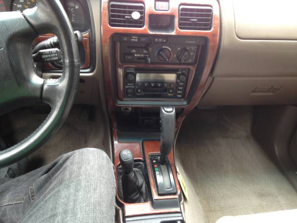

Another thing I find troubling is the interior pic. I searched around and I'm pretty certain this is an aftermarket wood dash - it is different from anything stock online. The owner swears its stock and that there are toyota emblems on it? My friend has the same yr Limited version and I have never seen this. usually with used cars where there is smoke theres fire and if this is an untruth then how many more are there?

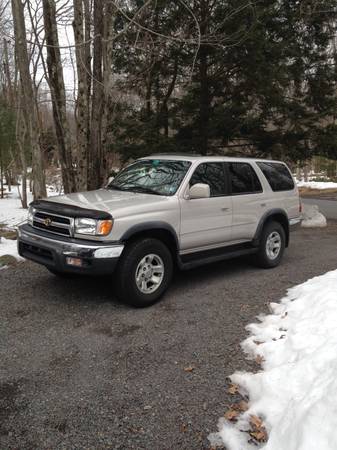

The pic of the trim on the wheel wells and running board does not look stock. Most 2000 4R i have seen have a touch of chrome around the wheel well and on the running board.

The stick on wood trim (that's what it is) is factory, my coworker has it. I think the SR5 4runners got that stick on stuff, and the Limited's got plastic that has a wood pattern on it. Don't quote me on that, all I know is that my coworker has the same stuff on his.
I would say the running boards and wheel flares are stock as well. Definitely seen the all black wheel flares, and the running boards seem to have the same shape as my OE ones.

Thanks for the responses. Maybe I was wrong with the wood trim. Maybe i was looking at the wood trim on the limited and the wood trim that comes with the SR5 is different. What had thrown me off was the slivers of wood that immediately surround the radio and A/C. That wood is on the Limited.
